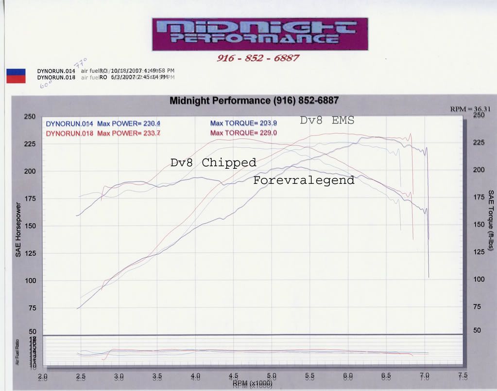

Heres an overlay of Forevralegend, Dv8 chipped and Dv8 EMS. Had to stretch it a little bit so its not 100% accurate, but you get the idea.
I have to point out Forevralegend owns the 2.9-3.4k range, which is the "normal" range for everyday freeway cruising.

I must say, this is my favorite dyno
Originally Posted by Forevralegend View Post
haha now thats a graph before dv8 went ems, now if you really want to see how much i would get bashed... check out the comparison between the current N/A dynos between our cars. Owch this one hurts
