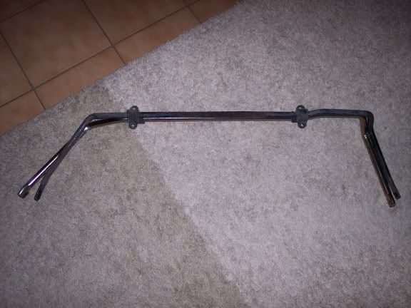

help please.... rear addco sway bar...
The bar isnt the same as OEM, the bends are off.... anyone else encountered this or should i ship it back?
Lots of people had that problem, the first batch of bars was made wrong. Where did you buy it? Some distributors received the wrong bar and continue to sell them from the looks of things.
Here's what it should look like if it helps you any.
ITR 00-106
91 6spd coupe
95 FZJ-80

i got the same bar kenso, but from the looks of it the end links seem very thick, i am not sure how it will bolt on properly
i think that was one of the problems. i think you can use a dremel to thin out the section.

Yea we all had that problem. You can either grind the ends down slightly to make them thin enough or fabricate a new bolt/collar setup that is longer. StevieRay made a DIY on the new bolt in one of the old swaybar threads.

how much did you thin out? i am thinking like half of it should be gone. lol

I didn't take that much off, maybe 1/8" iirc. It was a couple years ago, I've forgotten.

my bar looks correct at first glance but when set on top of the oem bar the bends are off, specifically(sp?) the on the left in kenso's picture the bend isnt angled enough. Its off about half to three quarters of an inch (not enough) thanks guys
edit: im gonna post some pictures this is ridiculous(sp?) how bad they screwed this up..

ok here they are..... the oem bar sitting on top of addco one

updated pictures

my bar looks to be the same as urs.

Has anyone else seen the pictures i posted? Has anyone else had this problem or did i just get the ugly duck rear sway bar?
The "wrong" bar we all got at first was WAY off, like not even remotely close at all, different style/shape altogether. Your looks like the right one, I don't know why it doesn't follow the shape of the OEM bar better. See if you can get it to fit, they never were 100% identical to the stock one.
