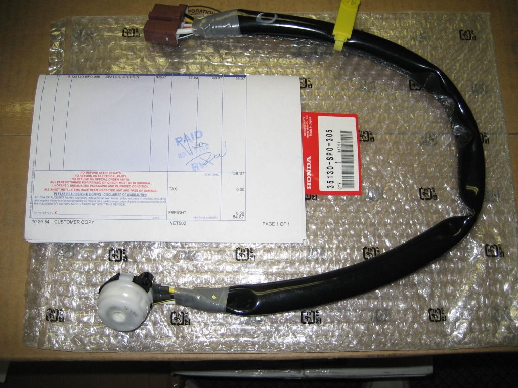

This is the "switch, steering" referred to above. Cost about $56.00 plus shipping from Acura of Augusta, if you decide to buy one. Mine is for a '91L coupe.
My switch worked; but the retaining screws were broken, and the switch
had gradually disconnected/separated from the lock out body. Symptoms
went from intermittent no start to no start when the switch completely
separated. Removing the lower dash made the problem visible.
