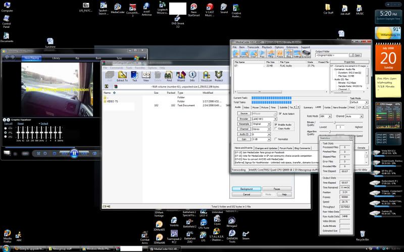

If you aren't going to wait for Nehalem, then I'd go for a simple Quad build. Since you are planning on gaming and want to connect the machine to a TV, I'd suggest an AMD 4870 or wait for the 4870x2. Both cards will have an audio pass-through and will allow you to connect to your TV via HDMI cable and have AVIVO HD capability.
Q9450's have been disappointing concerning overclocking. A $180 Q6600 G0 stepping CPU will net you nearly the same performance for less money. I have my Q6600 at 3.6ghz @ 1.37v under load.
Skip the 790i, DDR3, etc and spend it on the video card. You can get an Asus Maximus Formula motherboard for less, and have Crossfire potential at a later date if your single video card starts lacking. Crucial Ballistix DDR2 2GB (D9GMH) of ram for as little as $25 shipped that can overclock up to 1100mhz or more.
A Q6600 DDR2 build will be more than enough for a long time. I compress files, encode video, game (a lot!), and multitask without any bottlenecks or slowdowns. I have encoded DVD's, downloaded "stuff" (@ 2-3MB/sec), and played my video games at once.
If anything, spend the extra cash on two WD Velociraptors and put them in a RAID-0 configuration for even better performance. I usually upgrade almost everything once every 6 months. My Q6600 @ 3.6ghz, 4GB DDR2 @ 1128mhz, 8800GTX, ABS BS900w PSU, and water cooling loop have calmed my upgrading for almost a year now. The only game I have that it won't play on Max settings at 1920x1200 resolution is Crysis, but that game sucks anyways.
Skip the Sunbeam case. If you want a quality cube case, try a mountain mods (google them) case. More expensive, but infinitely better quality. Skip the 1TB hard drives; in my opinion its much safer to buy smaller drives and separate the data. I have lost my data permanently multiple times due to random failures, and have since switched to 250GB and 320GB drives (1.5TB total), and any failures will not devastate my data collection. If you really need two Terabytes, I'd buy 4 500GB 7200.10 drives and still go for the Velociraptor(s) for your OS and programs. I personally separate my OS, games, downloaded material, and videos on different drives. I prefer having the ability to format my OS drive without needing a partition to save the other stuff. Also, it helps to de-compress large files from one drive to another.
Q6600 - $180
Asus Maximum Formula - $230
4gb DDR2 - $50-$70
4870x2 - ~$500 (pending release price gouging)
800w-1000w PSU - ~$250
2x300GB Velociraptor HDD's - $600 (for OS, games, and programs)
I guarantee with that setup, you'll have a better experience than with a 45nm or Nehalem setup, a lesser GPU, and slower HDD's. CPU's aren't the bottlenecks these days.

There's a screen shot of my machine doing a few things (DV8's video in background). Not even maxing out the equivalent of two cores with the CPU at 3.2ghz. FLAC->MP3 encoding, MPEG video, Firefox, 8GB DVD unzipped using multi-threaded WinRAR.
