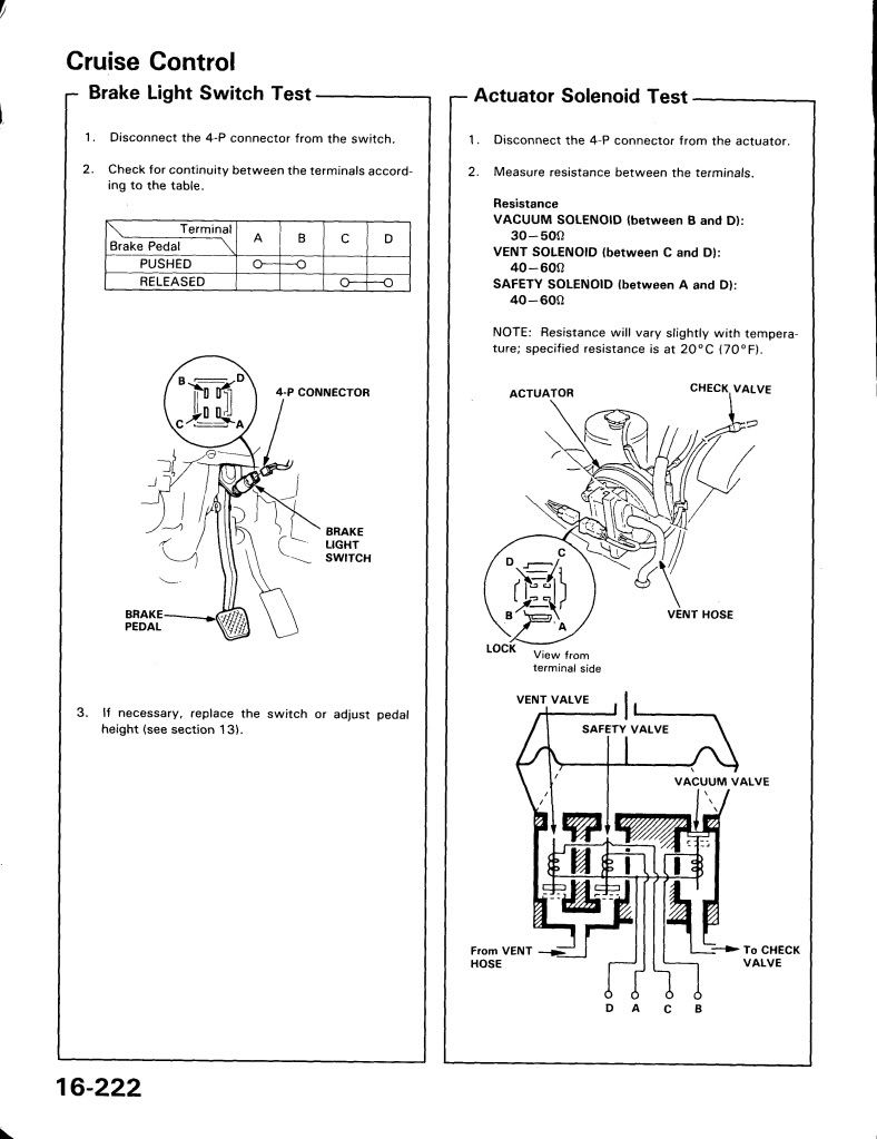

Also having trouble with cruse control. It lights up, but will not set. I have checked the fuse, it is ok. Tried holding down set button, but no results. Is there a sensor or relay that I can check? If so , where is it located? Appreciate any help you can give me.
3
For the cruise control, here's a couple of things you can test on:
