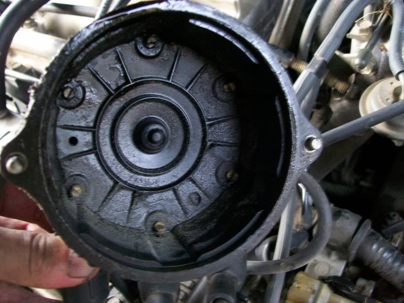

Here's how it looks after 3 nights work
This is straight out of the car, boot has been broken for a few years...

Above image concerns me Steve, tell tale signs; brown dust on your rotor could indicate failing distributor.

Hey thanks for hte heads up, I was concerned about it a few years ago as well. I suspect the rotor is actually red. I guess the easiest way to see if the bearing is bad is to pull the distributor off and see if it spins freely?

Wow that dizzy cap is absolutely wasted. Good luck with the project you will be really happy once all that stuff is taken care of. Are you replacing the brake rotors?
