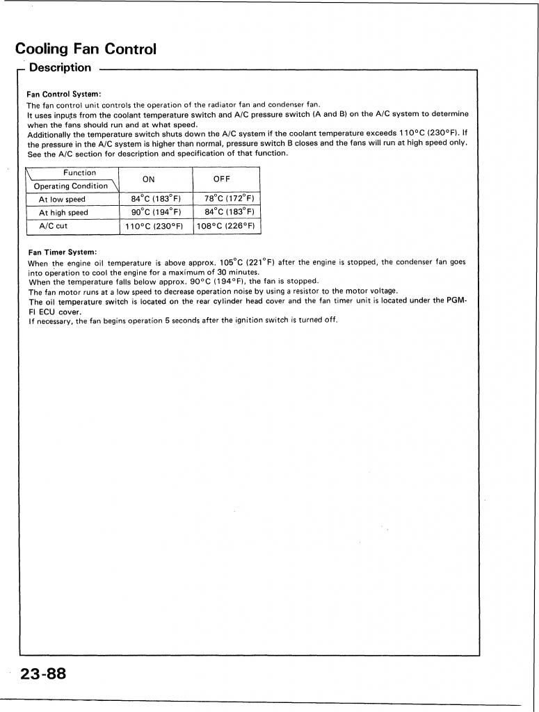

But, this is a copy out of one of the PDF's on the manual of the text:
Fan Timer System:
When the engine oil temperature is above approx. 105°C (221°F) after the engine is stopped, the condenser fan goes
into operation to cool the engine for a maximum of 30 minutes.
When the temperature falls below approx. 90°C (194°F), the fan is stopped.
The fan motor runs at a low speed to decrease operation noise by using a resistor to the motor voltage.
The oil temperature switch is located on the rear cylinder head cover and the fan timer unit is located under the PGMFl
ECU cover.
If necessary, the fan begins operation 5 seconds after the ignition switch is turned off.

Ah, I see what you mean. I just found it in the manual:
The fans run when the oil in the engine block gets too hot at 221°F. Thats something I didn't know lol. Do you have a thermometer gun to see how hot the engine block is?
