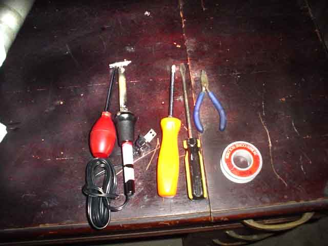

You will need some very basic tools to get started. Your going to need a Phillips(cross)
screwdriver to remove the various screws that hold on the trim pieces and the air
conditioning tube. Next you will need a flathead screwdriver to pry the tabs back of the
relay case so you wont need to unscrew anything to remove the relay. You will need a
soldering iron something that will melt the solder so it can reflow. I used a desoldering
iron because i could'nt find my regular iron it works fine. A couple items that you might
need along the way would be a roll of solder and possibly some small wire cutters.

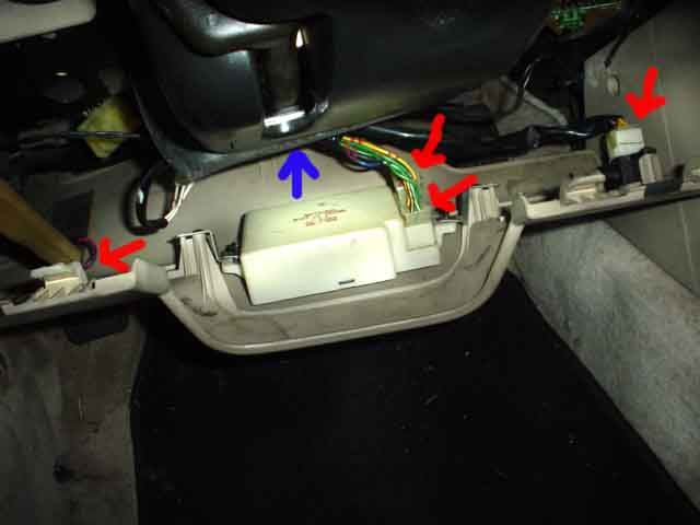

Start this whole project by removing the two screws that hold the kickpanel below the steering wheel
column. Once the two screws are out you slowly slide the panel down and forward so that the four tabs
come out of the slots. At this point watch out not to pry the panel out too quickly , there is a clip
at the back center that I bent trying to get the panel off.
Now that the panel is almost out and tilted down you have to remove four connectors: on the left is
a connector for the floor light , next to the left is two connectors for the rise up control box, Next
is another connector for the windshield wiper riseup switch. The Blue arrow shows where that clip is.
I found it easy to simply pinch together the clip and take it out of its retainer. Or you can forcefully
pull it out , it's your choice just dont break your panel.
Now there is an air conditioning duct that is in the way and makes it impossible to work where the relay
is so you must remove the duct by simply removing the two screws where the red arrows are and pop the duct
out.

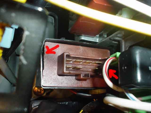

The red square shows exactly where the main relay is all you have to do is look up and youll see the
bottom of the relay which is a wierd red color. The arrow in blue shows the main relay's connector
which I have disconnected to remove it the way that I think is easier than unscrewing stuff out.
this shows the botttom of the main relay. The two arrows show where I inserted the flathead screwdriver
to make the two little tabs that are hold the relay in bend out so i can pull the actual relay out.
Be careful to not insert the flathead all the way in. You Should NOT insert the screwdriver more than
a couple millimiters you only need to make the tab bulge out so it doesnt hold the relay. Same goes
for the right side of the relay.
Once you have the tabs out the relshould come out easily , all you need to do is maneuverit out of the
plastic case and around that green fuseholder next to it. The relay should look like this , while the
black plastic top part still being attatched to the car. The top part wont be needed.
