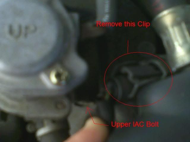

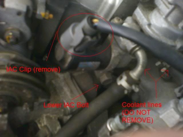

3. Remove Clip from IAC, there is also another Clip shown that needs to be removed. Completely set these aside out of the way. *PicsBelow*
4. Locate the 2 Bolts holding the IAC in place.
5. Remove Bolts. For the Lower Bolt use a 12mm Open End. For Upper Bolt, use 3/8 drive 12mm Socket.

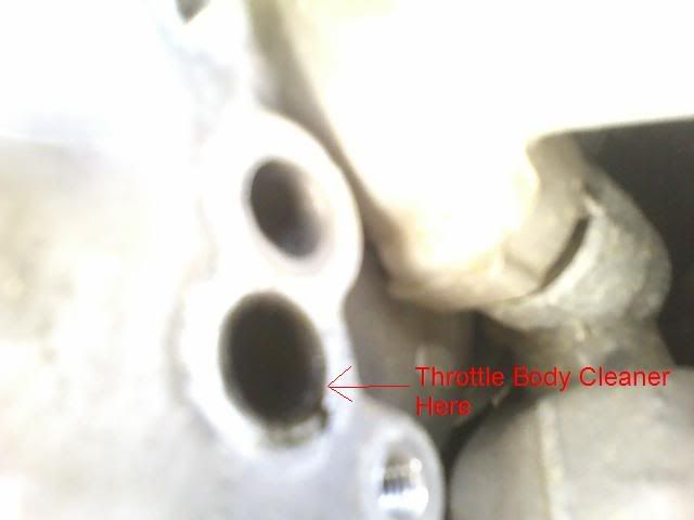

6. Pull IAC away from throttle body to expose the passages. *keep in mind the 2 coolant hoses attached, to not break or puncture them.*
7. Spray Cleaner and let sit for 4-8 hours. Clean out, and do reverse for install.
