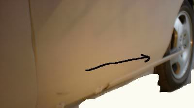

I'm only writing this becuase I had to spend 50bucks on brand new clips :eek:

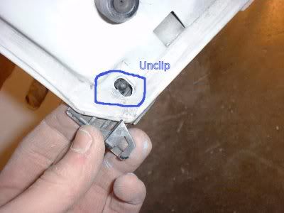

1. Unclip/Unscrew the small molding clip on the end of the door.

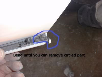

2. Slowly pull back the molding until you can remove the small clip
3. Now, go ahead and pull out the entire door molding.

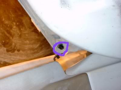

4. Unscrew the remaining door clip.
DONE and you saved yourself 50bucks :D
