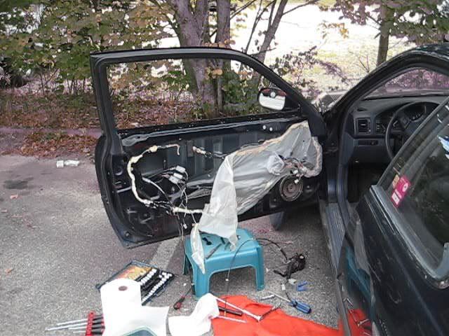

BeatleKnight, This may be overkill; but, here is a DIY for the door actuator. The
DIY involves accessing the window regulator to get to the actuator.. You might find that part helpful. Also, you may someday have to repair the door lock actuator. GL
Actuator repair DIY:
Acura Legend Door Lock Actuator DIY Fix
