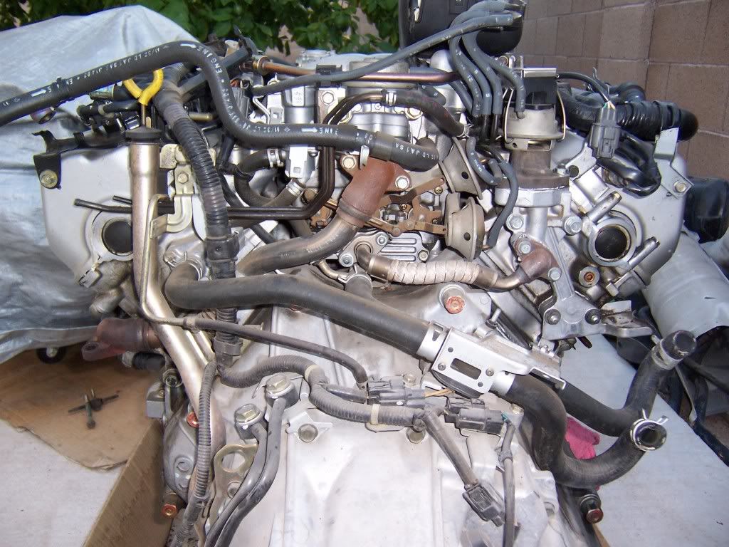

I am new to Legends and i have been chasing the problems around on this one, After fixing the coolant sensor issue, I thought i had everything fixed, BUT a short test drive and bingo the check engine light came back on. I pulled the codes, 53 and 23, which appear to be both knock sensors. Looking over the engine I found a plug on the top left rear of the engine that was unplugged and i can't find anywhere to plug it in. It appears to be in the area that the knock sensors wiring come out from under the intake, but i can't find the other end. Anyone know what i am talking about, i believe that someone left the knock sensors unplugged and i can't find where to connect them.

Everything plugs to the main engine harness so you should be able to find it that way. On the back of the engine (firewall side) I can only think of one plug on the drivers side, next to the bracket you use to lift the engine out and on the passenger side there are two plugs by the EGR valve.
a picture of said connector would help.
pictures in work, This plug is from the main engine harness on the drivers side, rear of motor. I can't find what it plugs into.
Check your o2 on that side.
O2's both connected, their wires run down along the side of the block and connect in the front.
Ok i will do, it seems the pictures have minds on their own, can't get a good copy on my computer, but will keep trying.
Here is a picture of the engine from the rear, the only connector on the drivers side in the rear is the one that goes to the knock sensors (just behind the brake booster vacuum line).
thats the plug, now to find the other end on my motor, guess intake has to come off. :p
