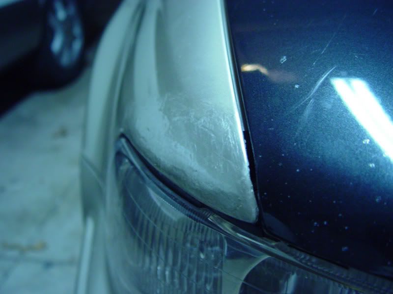

well i had a dent on the end of my fender so i decieded to bondo it, it turned out really well except for the fact that i used my touchup paint brush so it looks ripply now. i wish i got some during pics but i didnt :(

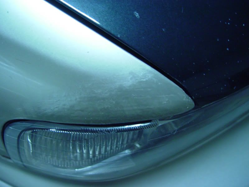

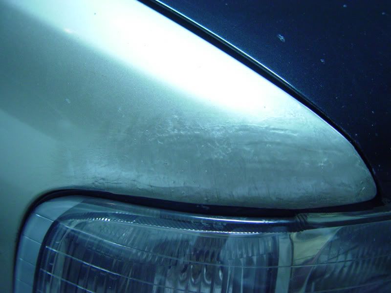

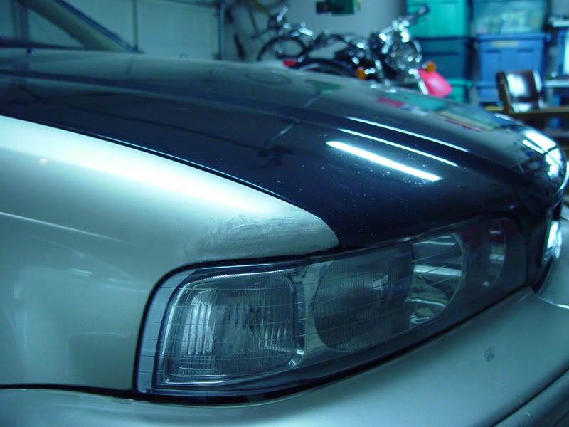

well heres what it looks like, tell me what you think

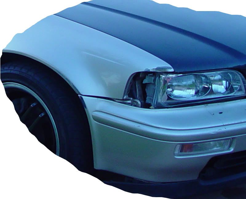

what it looked like originally

Wet-sand that thing at latest tommorow after school, Call me tommorow if you need advice.
:werd:
BTW, did you use any of the Bondo spot putty on top of the initial bondo layer? If not, that would have helped smooth out the pits and ripples in the initial coat.

yeah, buy some glaze if you have any pinholes. Remember to spread the bondo 3''+ over the entire section so everything blends nicely. Your spray job is throwing off any opinions I could make. But from the looks of it, the fender/hood section needs some cleaning up.
160 Posts
That's more than a wetsand is going to take care of. Start with some 600 grit sandpaper and start smoothing it out.... The paint is going to look real noticable either way you cut it since it's a touchup pen. It will look 100 times better if the surface is smooth and matches the rest of the fender though...

my goal when fixing my fender was just to make it look better than haveing a 1/2 dent on that corner. thats why i just used my touch up brush
