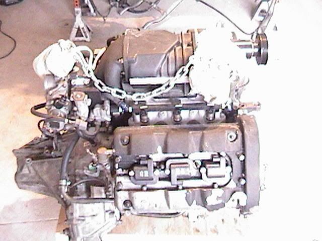

07/11/08-Engine finaly out!!! Sorry but this kind of project is kind of slow is just like that...

Yes SC will stay but will required custom scooped hood...
