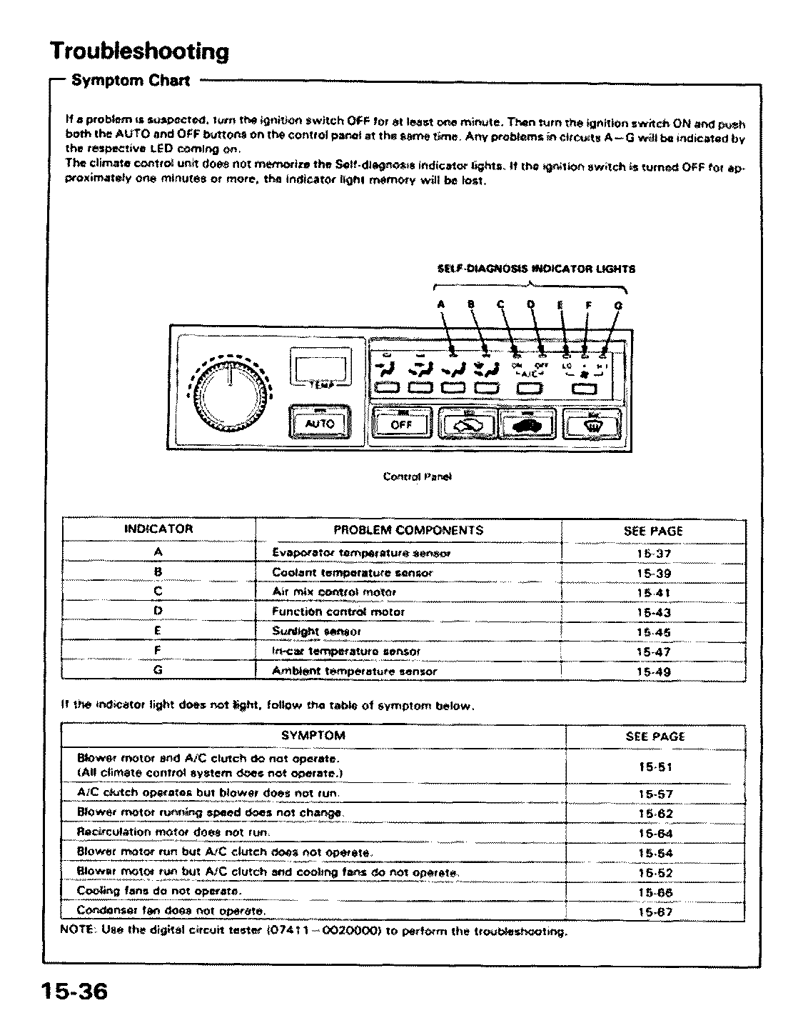

On your auto climate, press and hold down the AUTO and OFF at the same time. If a light turns on in the manual control area, you have a bad item that needs to be replaced:

so i tried to do the code thing, and its a no go. something is out of wack forsure. i cant even do the diagnostic

As Lazy said do the diagnostic procedure.

here is one thing I read that was relevant in the manual, (22-6)
NOTE: If you have one of the above symptoms, but no self-diagnosis indicator light, one df the basic heaterlair conditioner
components controlled by the system could be the cause, i.e., blower motor,A/C compressor clutch, recirculation
control motor, etc. Refer to the standard Heater and Air Conditioner section for troubleshooting and testing.
The manual also has a diagram(22-8) of the basic system components. Everything before the control unit flows through a "triple pressure switch" which appears to have its own ground. Check that out.
Tough because even the PCM is a possible cause. Follow the flow charts and tests. Don't throw parts at the problem. Start with the easiest tests like physical connections and grounds. Good luck my friend.
