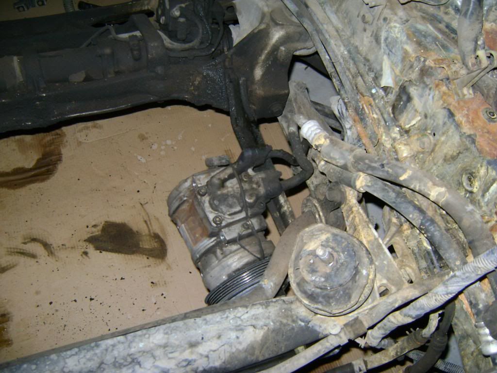

First you need to get a replacement hose and drier at a minimum. Look on the online manual as it will give step by step on most things. To access the a/c hoses you will need to remove the battery and tray so you can see your hoses. Here are a couple of ugly pictures but will give you an idea:
Here is the compressor and the two hoses coming off of it (these are from a 92 so both hoses go to the front, 93-95 one hose goes up and over the engine instead).

As you can see the hoses go directly under the battery tray.
Ari One thank you so much for the pictures!!! i was able to wake up this morning and get right to it, i got the hose out and can no inspect the damage that was done and fix it up, THANK YOU!!!!
It's all fixed and the air is freezing cold!!! thanks for all the help guys, saved me more than $400!!!
