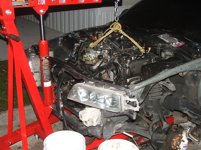

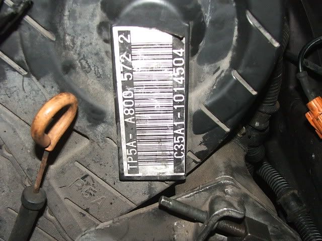

Today was learning experience ..... I woke and decided to do a 3.5 swap today? Now who wakes and just says Ill do a 3.5 swap to day..me I was board! Besides the point just wanted to say that not only am I going to have a 300 hp power legend Im going to be the first to have a 300 hp 3.2 and 300 hp 3.5 in the same legend! But wait theres more I have have pictures for you yea i said you skeptical people!
