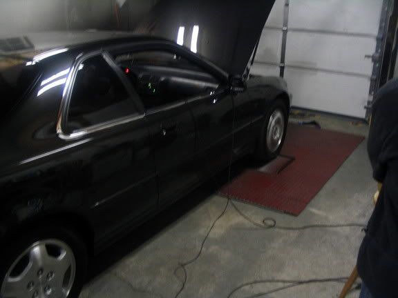

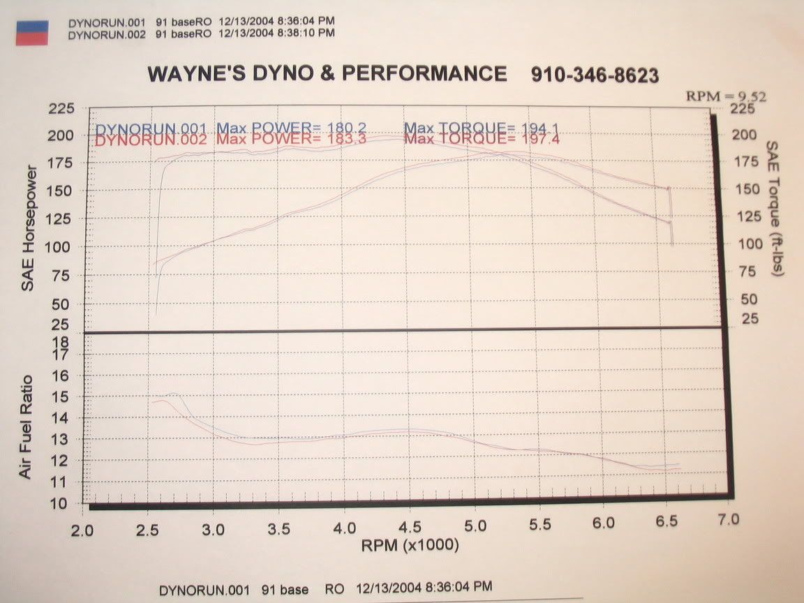

Just got back from having my coupe dynoed. My mods are custom CAI, testpipe, Bayou stage II chip and Type I auto crank pulley. The dyno was a dynojet. Best run- 183.3 hp & 197.4 tq. I'm pretty happy with the results, can't wait to get my Type II manifold back from Extrude Hone and dyno again. Let me know what you guys think.

You have the highest numbers for Type I n/a. You beat out Tyler. Good job and nice numbers! I think having 216k on the odo has something to do with it. All that carbon buildup is probably boosting your compression a bit.

Congrats, you now have the highest hp type I n/a (by .1 hp) ;)
but a bit more torque. i think the manifold will help a lot.

when you get your manifold on your gonna lose some bottom end, but your top will pickup nice. I did the same thing to my type I. Now doin the type II swap, plus weight reduc and all that, ill post picks. I feel bad seein my car with everything stripped off it, it's really cold here, maybe i should put a blanket over her or somethin?

Nice run!! Great torque!
Wish I can get my torque that high... of course without sacrifising my HP ;)
I read you are going to put Type-II heads on your engine, so prepare to lose some of that torque as the Type-II put out less torque, but a nice increase in HP though. My best run was 182 ft-lbs of torque but 211.4 whp.
Does a CAI help alot with pumping up the TQ?

Right now I'm just installing an extrude honed type II intake on my type I heads. Hoping to keep the type I torque characteristics while gaining some high end hp. I don't know how much torque I gained off the CAI, never dynoed before it was installed. I'm sure it is a contributing factor, as well as the fact that I'm running the stock exhaust w/ testpipe (at the expense of some hp). I'm trying to gain as much hp as I can without giving up much torque. I'll find out soon how it all turns out I guess!
