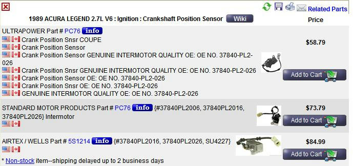

How much are Crank Position Sensors in the US?
Only place I have found them so far is through Honda over here and its $300
Hello
Rock Auto Parts RockAuto Auto Parts usually has the lowest prices on these kinds of parts.
Here is a screen print of the crankshaft position sensors for sale on Rock Auto Parts website for your 1989 Acura Legend:
