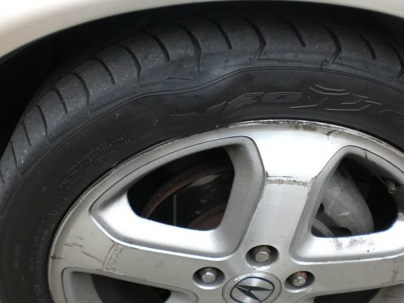

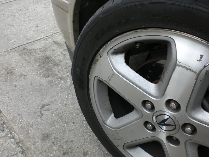

yea man, thats not repairable. the cords inside the rubber that hold it together have broken/snapped. It would be a good idea to replace that tire ASAP. ask the shop, you might get lucky and they might have a comparable used tire (wearwise)

write a complain to the city and take pictures as proof of the pot hole and the effect it had on your wheel/tire. they will cover your damages. philadelphia has holes like no other and a few of my buddy was reimburse. doesn't hurt trying.

looks like tha pothole won the round. Make sure you get the wheel checked out when you replace the tire ... make sure its not cracked. And dont drive the car on the highway until after everything is inspected/replaced.
Low profile tires suck !

I hate potholes. I hit them couple of times already and luckily I haven't got a single bump on the tire. But DAMN man, that is one nasty lump!!
