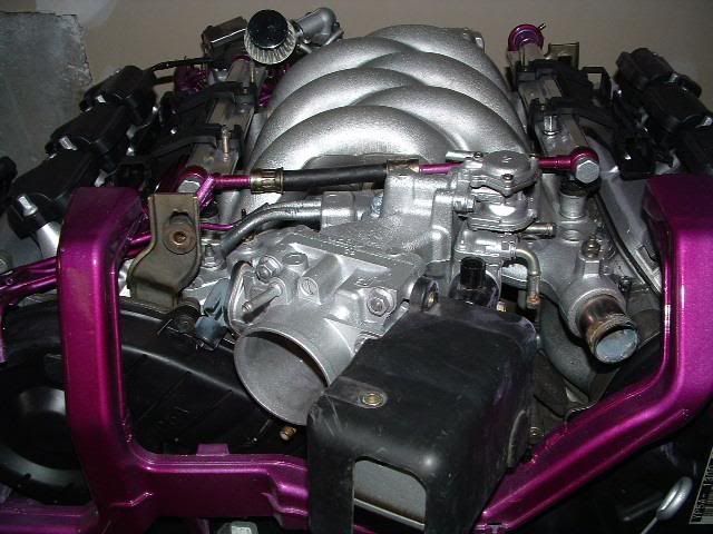

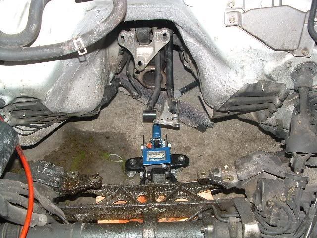

Ok this one was a solo shot and it took about 60 hours (yes 60) to get her out. of course had I done more home work and read the service manual (which I can provide the necessary portions for those to do this after me, it may have taken half that time. Later I will edit this post with some to do's and not to do's (that I did) and keep a progress report going from here. So without further-a-do,
And of course a teaser pic of what is to come (it is outdated though, now has the TII manifold and cams)

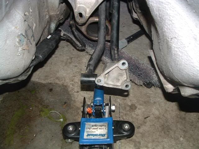

Here's another outdated teaser pic

#11 ·
Thanks not much yet it is a stock 3.5 with a ported TII manifold and cams, a aftermarket breather and megan racing FPR.

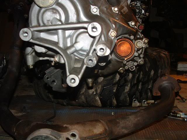

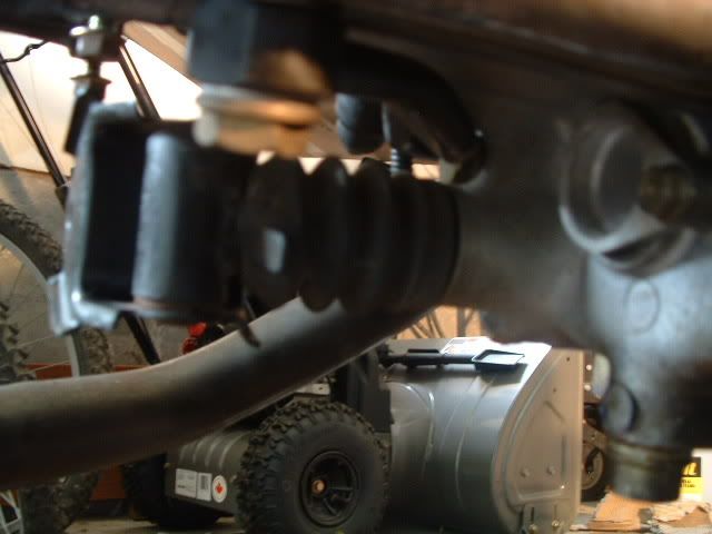

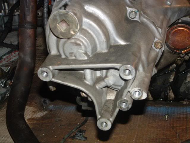

#27 ·

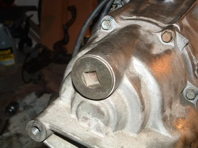

Ok I am stuck, I can't get my Diff or Tranny off so any tricks and tips you guys know let me know. PS teh extention shaft might be engaged so tips here will help too. So you know where I am stuck
Tranny: all bolts out and it is balanced on jack stands connected to the engine which is on the hoist but it won't come more than a 1/4 of an inch off? WTF.
Diff: All the bolts are out housing cover is off (diff fluid smells as always) and diff itself is out but I cannot get the housing off the engine. I can't remove the extention shaft. or the oil bearing seal. Please share your secrets on how to do these!
#28 ·
is the trans auto or manual?
to pull the extension shaft, pull the sealing bolt on the back right side of the bellhousing (bellhousing facing away from you). I believe it is a 1/2" square plug (use a breaker bar). Then, you use a screw to pull the shaft out.
#31 ·
Oh hell yes, Thank you Ranger Joe and Matt both I figured out how to get the extention shaft to release. I had a hell of a time getting the cap over it off so I checked to see what all turned when I turned the cap using the 1/2" drive and the who crank turned so I locked it up from the front side with a torque bar and was able to loosen the cap. Then I took a M8 (Ranger Joe) screw that was long enough for me to use the backside of a hammer for leverage to pop it out :Woot:

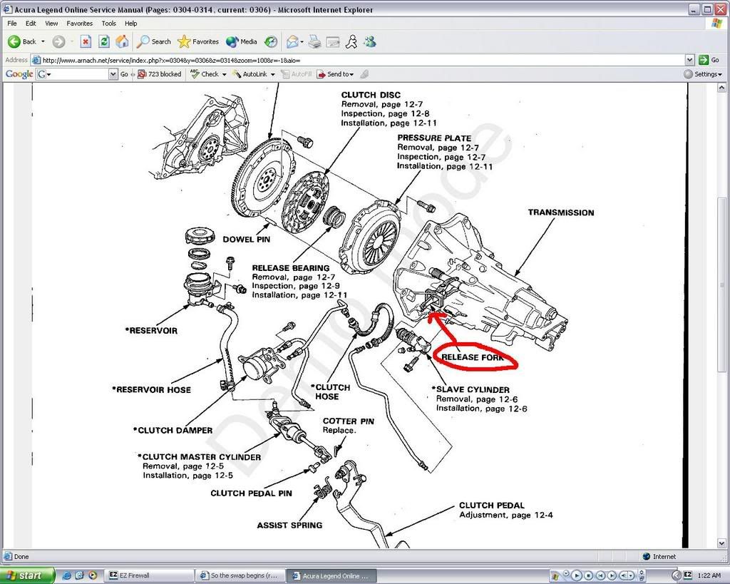

#35 ·
Ok this is going to become a community project I can't get the Fing Tranny off am I missing something it seams to be stuck to the clutch or the flywheel some how and the service manual did a $#!t job of documenting how to get the tranny off. and yes the exention shaft is released. Help anyone chime in!
Did you pull the clutch fork away from the release bearing to disengage it? Did you remove the dust cover over the flywheel?
#36 ·
I am not sure if the clutch fork and the extension shaft are the same I have removed the dust cover from the flywheel though. Is this it

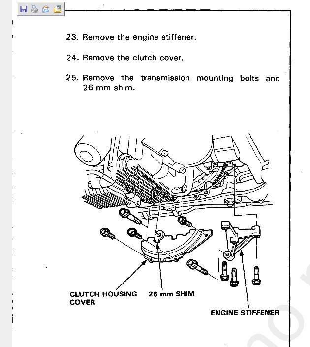

#37 ·
The dust cover I'm referring to is at the front of the trans, at the bottom of the bell housing. It's a sheet metal piece bolted in place with a few 10mm bolts. The clutch fork is the piece that the clutch slave cylinder pushes against when you depress the clutch pedal. Not related to the ext. shaft. If you don't pull the fork out it will definitely cause a problem in removing the trans. You can see the fork in this link.
http://www.arnach.net/service/index.php?x=0304&y=306&z=0314&r=-1
#38 ·
Hang in there with me I am going to upload another pic ok edited with this pic is this it
#40 ·
Hey that is 10X more detailed than what I am working with. Thanks that is not in teh service manual F :nutkick:<- me
