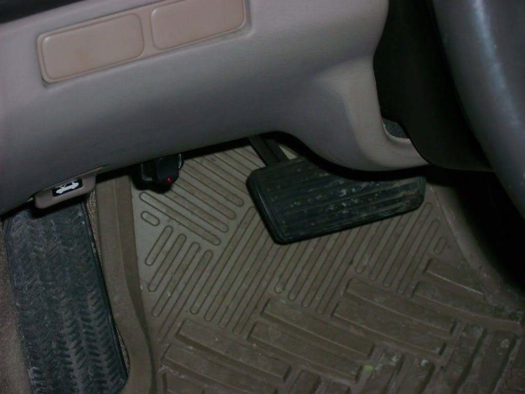

got it installed by me and my friend
got a cheap pepboys package
but it sounds good
heres some pics/a video
Since i have a stock radio, the switch to turn the amp on/off is installed down under bottom left. when i turn the radio off, but not the switch the sub makes a constant note so I dont forget

you need to connect the remote turn on lead of the amp to a switched 12v source on the radio.
the radio has a 12v source (battery power, this is its memory and main power source)
and it also has a 12v switched source from the ignition when the key is in.
run a relay and use that as a switching source.
its the yellow/red wire on the oem radio harness.

And the switch wasnt my idea, it was my friends
but I like it because I dont always want bass, like if I'm listening to music that really doesnt sound good with bass.
