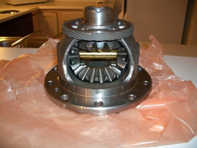

Hondaman's LSDs are a straight replacement of the stock differential, if I recall correctly. Therefore you CAN indeed use the LSD and the FD kit at the same time. :) Here's a pic, the LSD replaces the red part, the FD set replaces the green:
http://www.kotetu.net/Legend/lsd-fd.jpg
You can't correct the speedometer, as far as I know. The speed is most likely calculated from RPM and wheel diameter using a formula built into the ECU. Even changing your wheels is going to throw off the speedometer. With a final drive that is higher than your stock, you will not be going as fast as your speedometer thinks you are going.
#7 ·
kotetu said:
I can hunt around and post up results from B-series (ITRs, etc) and probably a few H22's, as they have had final drives out for a while.

kotetu said:
I'd also be very happy to hear if anyone has actually taken out their differential and counted the teeth on the gears.
I have both an auto and a manual diff. So I'll try and count those teeth this week coming. I have to open the manual to install an LSD anyway.
#26 ·
Here's a quote from the manufacturer of the final drives: "Precision machined to exacting tolerances from high-tensile forged steel, heat treated and shot peened, you will not find a stronger, more reliable product on the market."
It will work with manual or automatic, no problem. I'm even considering getting the automatic differential or at least the differential case to save a bit of weight. :D
hotlava - while you are at it, weigh them both! Do you know which Type they are? (type 1, type 2) You need to count the teeth on each of the GREEN parts I highlighted in this picture:
Then divide the ring gear tooth count by the pinion gear tooth count. Thanks!
