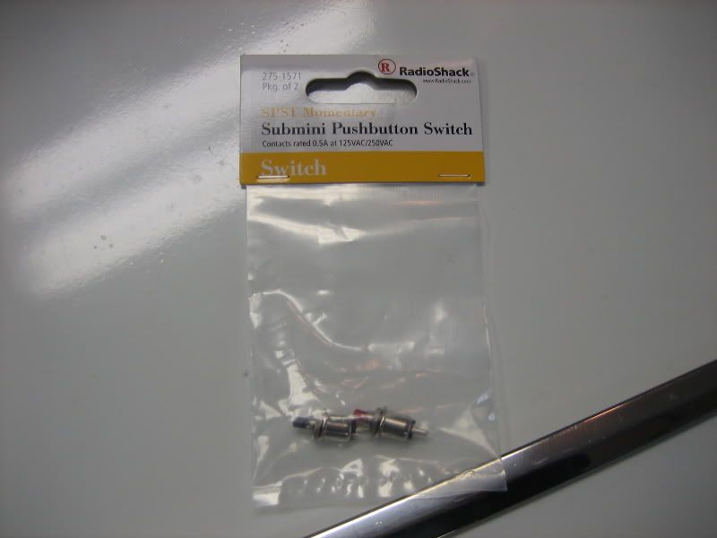

I purchased these momentary push buttons from radio shack for about $2.

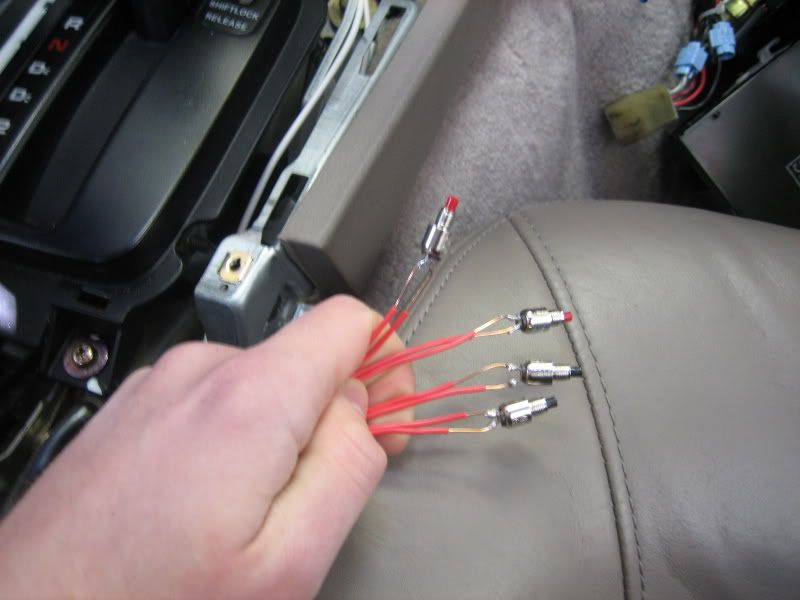

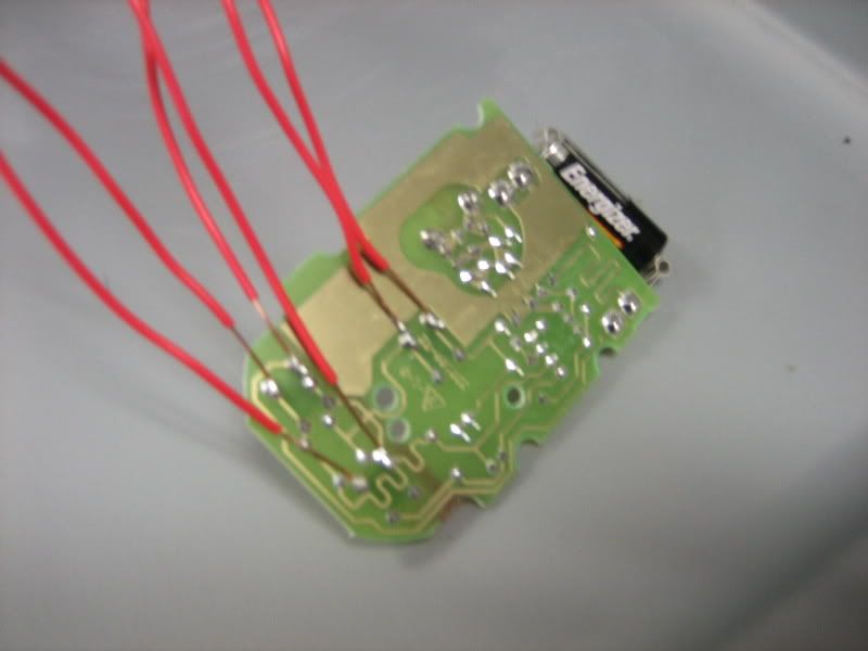

Then you must take apart your opener. Once you get it open, look at the circuit board and find the post on the back for the opening buttons. I decided to do a botton for all 4 of my doors.(3 on the Genie and one on the Liftmaster) solder a piece of wire to these post.
After measuring an apporximate length of wire, solder the other end of the wire to the post of the buttons.

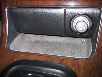

Now you must remove the center console and wood trim to hide the remotes. To do this first remove these two screws in the coin tray.
Then pull up the wood trim and set it aside.

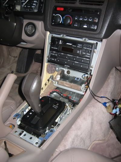

Next remove these 5 screws to remove the center console.
Then remove this single screw that is inside of the center arm rest.
After remove that screw, pull of the plastic cover on the back of the center console. (all of the yellow stuff is for the SRS system, so be careful)

Next, remove these two screws and then remove the same two on the other side.
Now you should be able to lift the console out of the way. Do so and set it aside.
I chose to mount the buttons where the heated seat controls would be. I removed this plastic tray and drilled 4 holes to hold the buttons. I staggered them so I would be able to find them easier without looking.
Reinstall the plastic tray and put it back into the center console. Place the center console back into the car and run your wires to your desired location.
