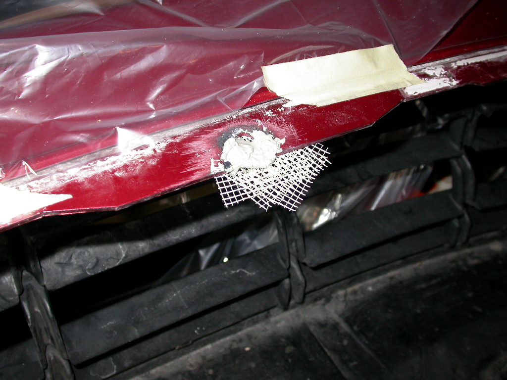

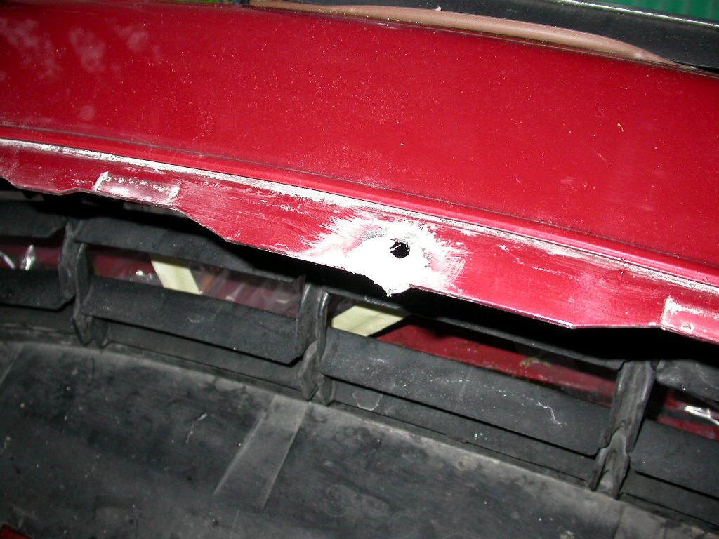

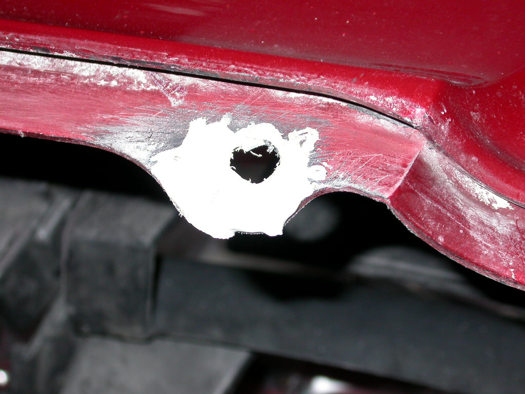

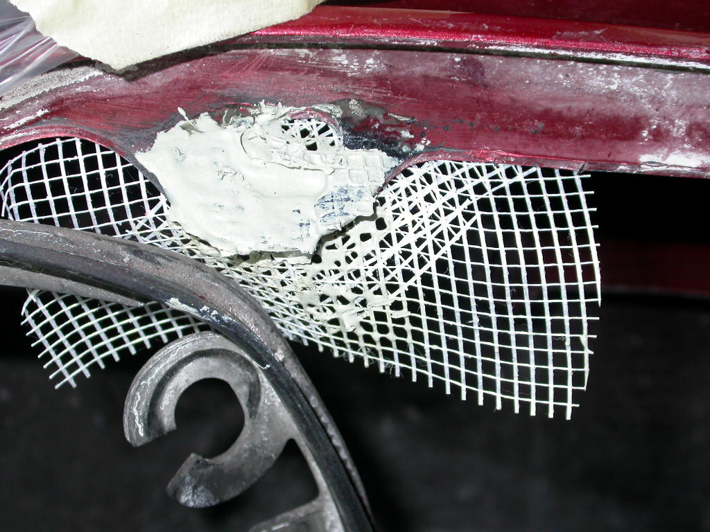

I recently tore off my front bumper when backing out of my driveway by accident. Four of the mounting tabs that hold the bumper securely were ripped off.
So instead of spending $$$ on getting it fixed by a body shop I found a product that worked excellent in repairing my bumper. Its called SEM Problem Plastic Repair and it fixes bumper damage (duH) whats unique about this product is that its a specially designed epoxy glue that adheres to PPO plastic (the plastic our bumpers are made of) other all purpose epoxies are not the best solution for repair as they cannot mold w/the chemical properties of the bumper and thus eventually fall off.
This kit was about $15 or so shipped from Vinyl Pro
http://www.nb.net/~vinylpro/products.htm
You can also get it elsewhere but this place was the closest to me and offered great service.
Overall, this product is easy to use, you just have to use the glue and mix it into the damged parts of the bumper and then let it dry . The most important thing to do is PREP WORK. As anyone knows, good prep work ensures good results. I had to sand down the sides of the damaged holes and clean it with the cleaner shown in the picture. This ensure that glue will properly bond to the plastic.
Once you have it all prepped you are ready to start putting the glue on. What I did was spread over the entire hole and use reinforcing tape (shown in picture) to keep the glue from dripping. You let it sit for about 1-2 hours
I did this for all the damaged tabs
Then I sadned it down and put it right back!

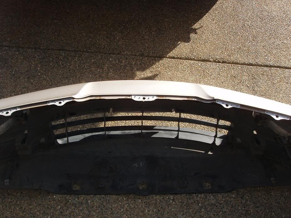

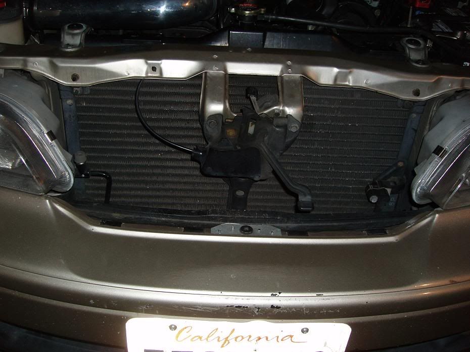

This is INCREDIBLY useful for me also, but I am curious about the plastic screws used to attach the bumper. I called my dealer and they said thgey are $4 a piece and come in sets of 13-but in the following pic:
The 2 plastic screws look to be different sizes. I only had one remaing screw when my bumper plopped off, so I do not know if I have the right kind to match up. Are all of those plastic screws (Acura called them 'Christmas Tree screws') the same size? Should I be able to match them with the 1 remaning I have???
