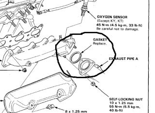

Well I just changed my oil and had a chance to get under there and its really hard to tell. It is definitely on the Y pipe ( drivers side) at what seems to be the upper most connection if that makes sense after the precat toward the engine side, so maybe the gasket between the precat and the manifold?. Its a tough area to get into but I don't see a hole or broken bolt some it must just be the seal. Do you have this seal? This looks like a pita to repair its in a tough spot and I know those bolts are gonna be rusted.

How do you know the leak is there? is that where it sounds the loudest from UNDERNEATH the car? if so, it is going to be a pita. At least both connections to the headers need to be disconnected and both gaskets would need to be replaced.

those "bolts" are studs screwd into the exhaust manifold. The only way they are coming out is to take off the exhaust manifold and take it to an exhaust shop where they can heat and bust them out. If they are broken it would probably be cheaper to find a member who had installed OBX headers and would sell you that side manifold for really cheap. That ring gasket will run you anywhere from 3-12 dollars.

This is not entirely true- The nuts will come right off if you spray them with some anti-rust. Then you just need 2 to 2.5 feet of extension on a 1/2 inch ratchet with a 14mm socket. It is easiest that way to at it from underneath the car, otherwise, it will be hard to get any leverage or movement from within the engine bay. You DON'T have to take off the manifold! Their will be enough slack to pull the pipe out once you loosen the nuts from the bottom.
