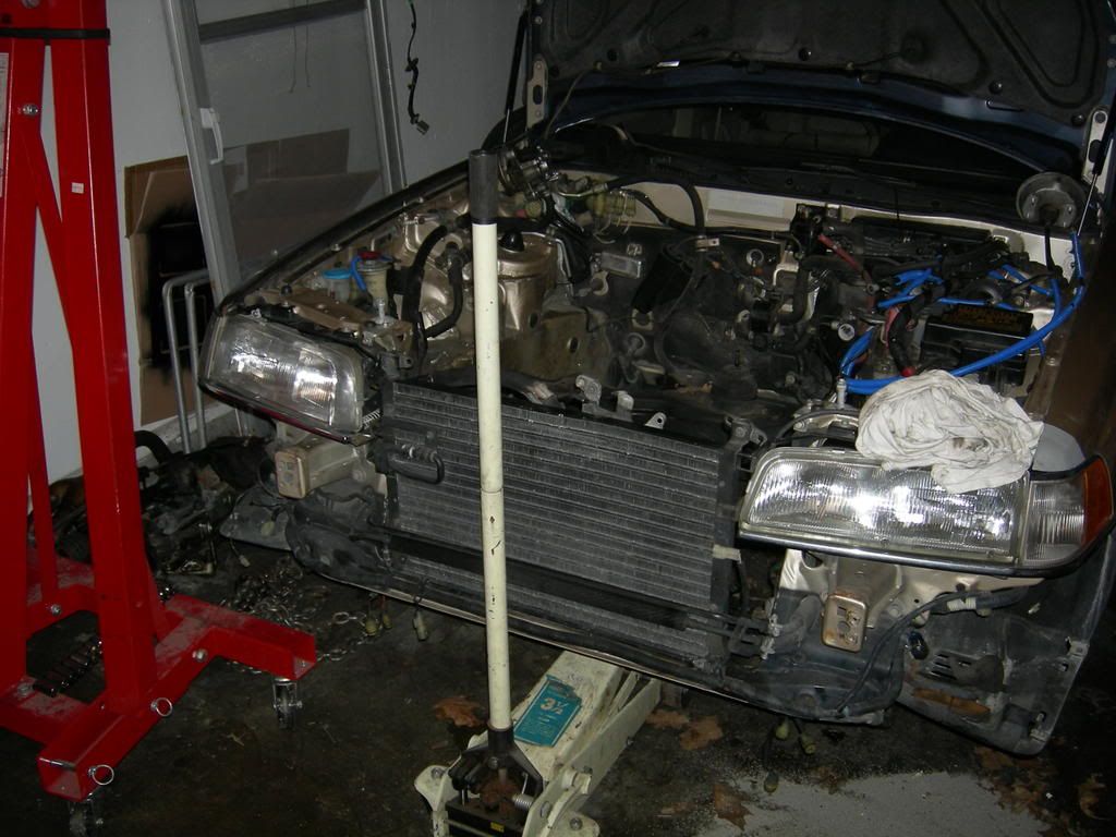

got the engine pulled several months back

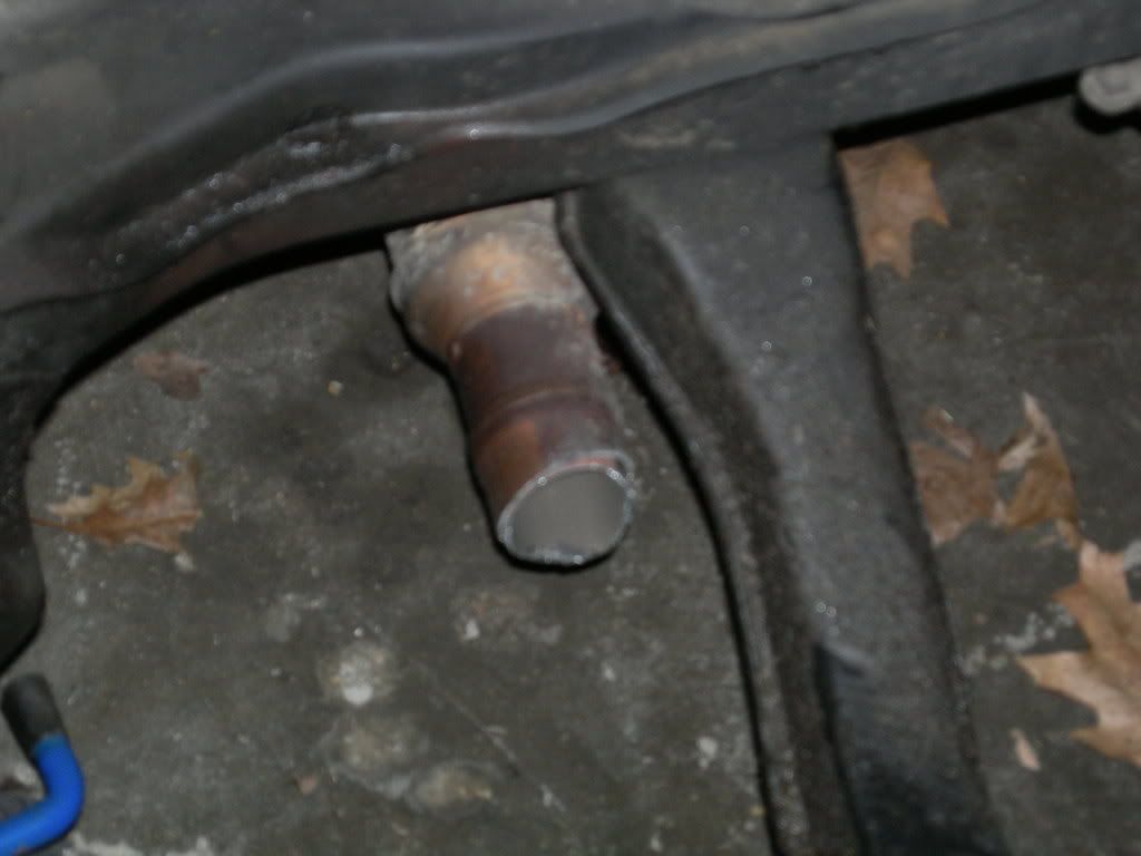

this is how u remove the exhaust with rounded bolt heads...with a fuckin sawzall. i would only suggest this if u r replacing with obx headers as i am though lol

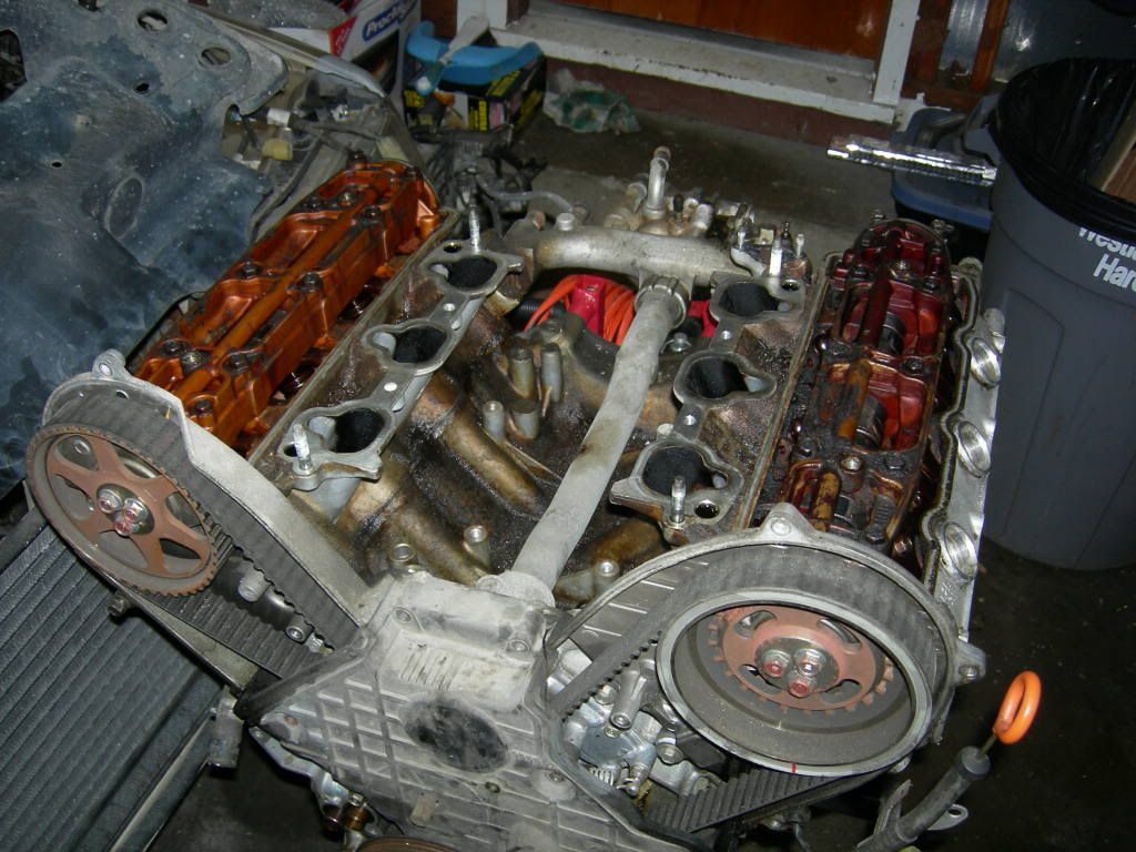

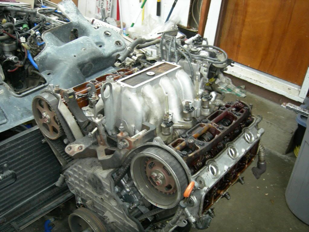

started pulling apart the engine last week for rebuild.
Photobucket

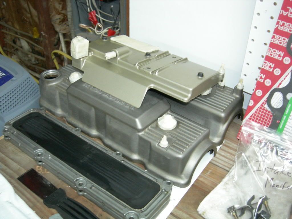

covers prepped for paint
Photobucket

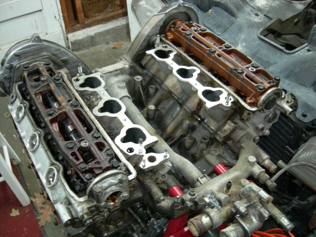

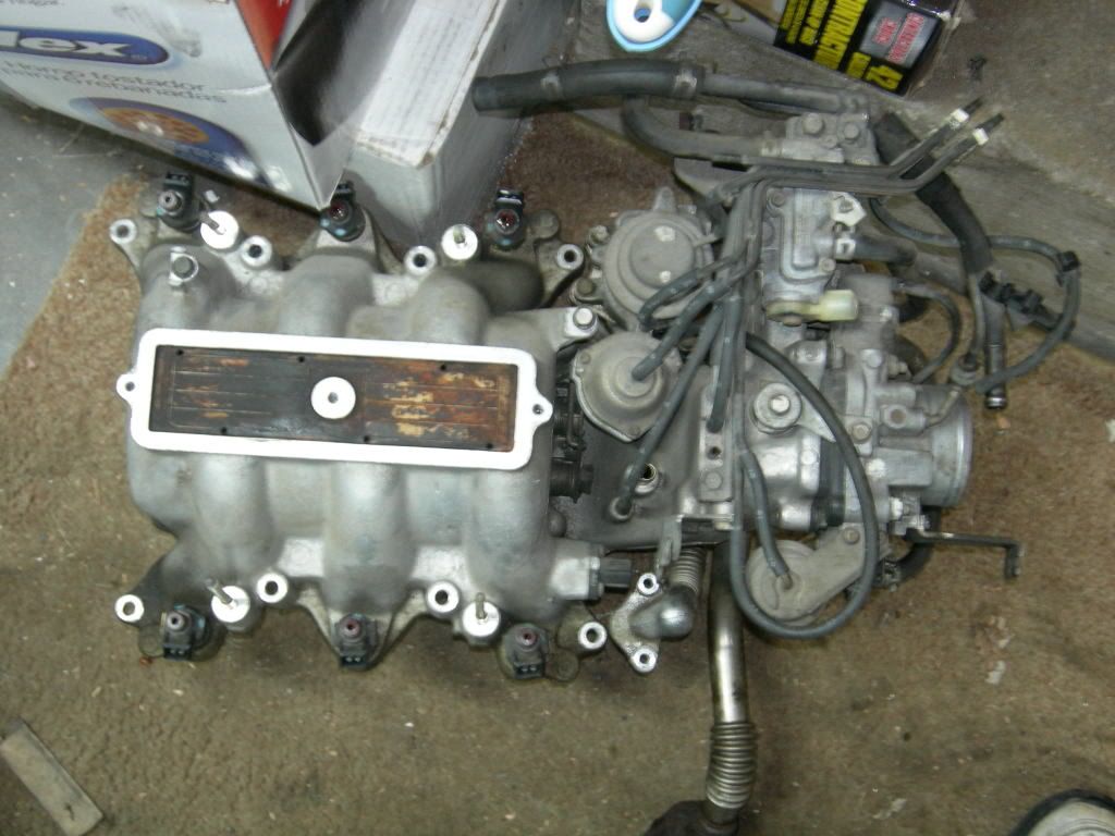

intake manifold removed
Photobucket
Photobucket

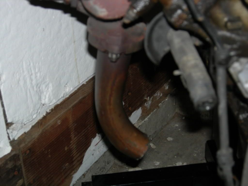

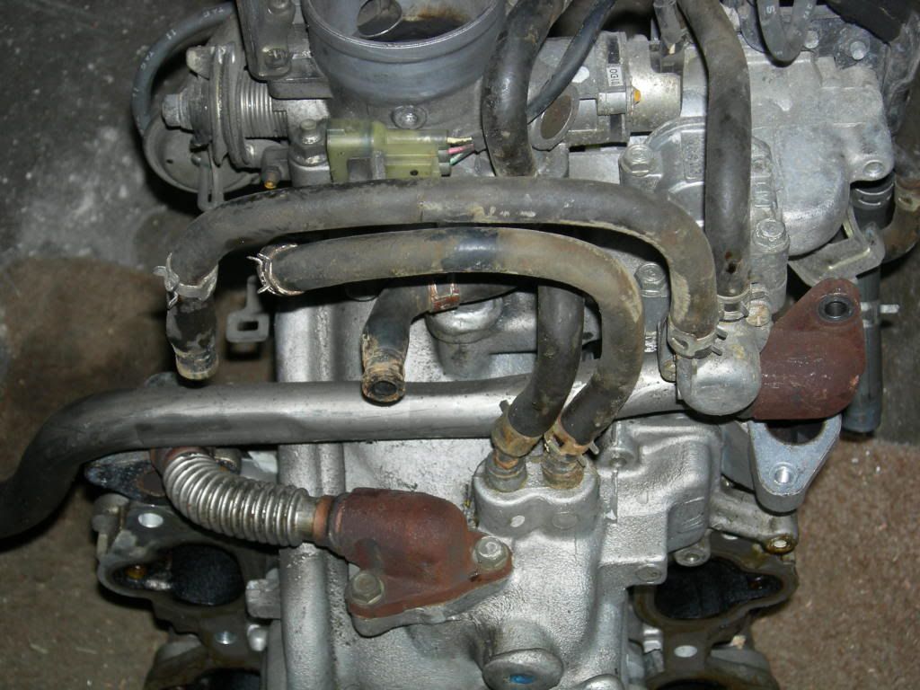

also this may be a good note to most of u out there with cars of this age. hoses i never would have thought to check for replacement. these hoses look terrible. not to mention the rusted out water pipes they connect to. i don't know if it was the coolant used or what.
Photobucket

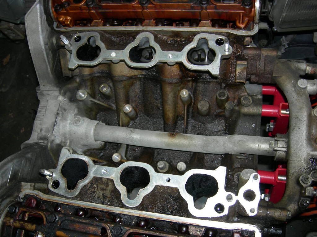

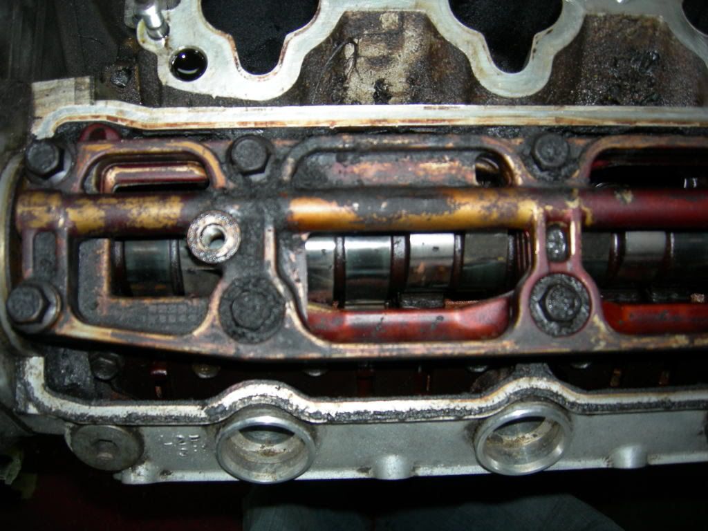

and this is what carbon buildup looks like under your valve covers. use seafoam kids!!!!!!
Photobucket
that's regular for any 20+ year car. the hoses are still good unless one is melted or cut. completely reusable. just don't expect them to last another 20 years. as cheap as hose is at your local auto store though, it's better to just replace them. it's just nice to know you don't have to if you're runnin low on cash during a project.
#7 ·
Actually quite the contrary...those hoses are typical culprits on the G1 for disappearing coolant for unexplainable reasons...they develop small, slow leaks and are almost impossible to pinpoint the location of the leak due to their close proximity with one another and the fact that they are hidden by so many other things...I would never reuse those bastards bc they are so hard to change as it is already :lol:
Change em all out I say...and dont forget the oil cooler lines that go behind the engine as well!
#8 ·
it's all in the time taken to avoid that during the work...
remember, i just pulled my motor and cleaned my entire intake wi/o buying a single oring or gasket. and the only hose i changed was cuz i was trying to tap in my PVC on an aftermarket conefilter.
i'm still using the OEM clamps too.. just made sure they sat correctly.
no leaks.. air or coolant.
if i keep racing the car around dallas i probably will, but if i was a normal driver i'd say everything under the hood is good for a few years.
edit: given, i got lucky none of the hoses were cut or rotting.... like some that i've pulled off of classics. those you gotta replace. but the rotting and corrosion itself is natural.

It would be a very good idea to clean all the varnish and carbon out of the heads and valve train. If you have access to a power washer you can make a good start by spraying solvent on the parts and power washing them. After that a machine shop could soak them in a solvent tank to clean it up further.
I would replace all the hoses and put a complete gasket set into it.

sam o nela said:
Also I noticed what looks like a pinhole from corrosion on the water pipe that goes under the intake and between the banks....had that things started leaking, talk about an "unfindable leak!!"
i don't actually think it was a pin hole yet. i'm definitely replacing it though.

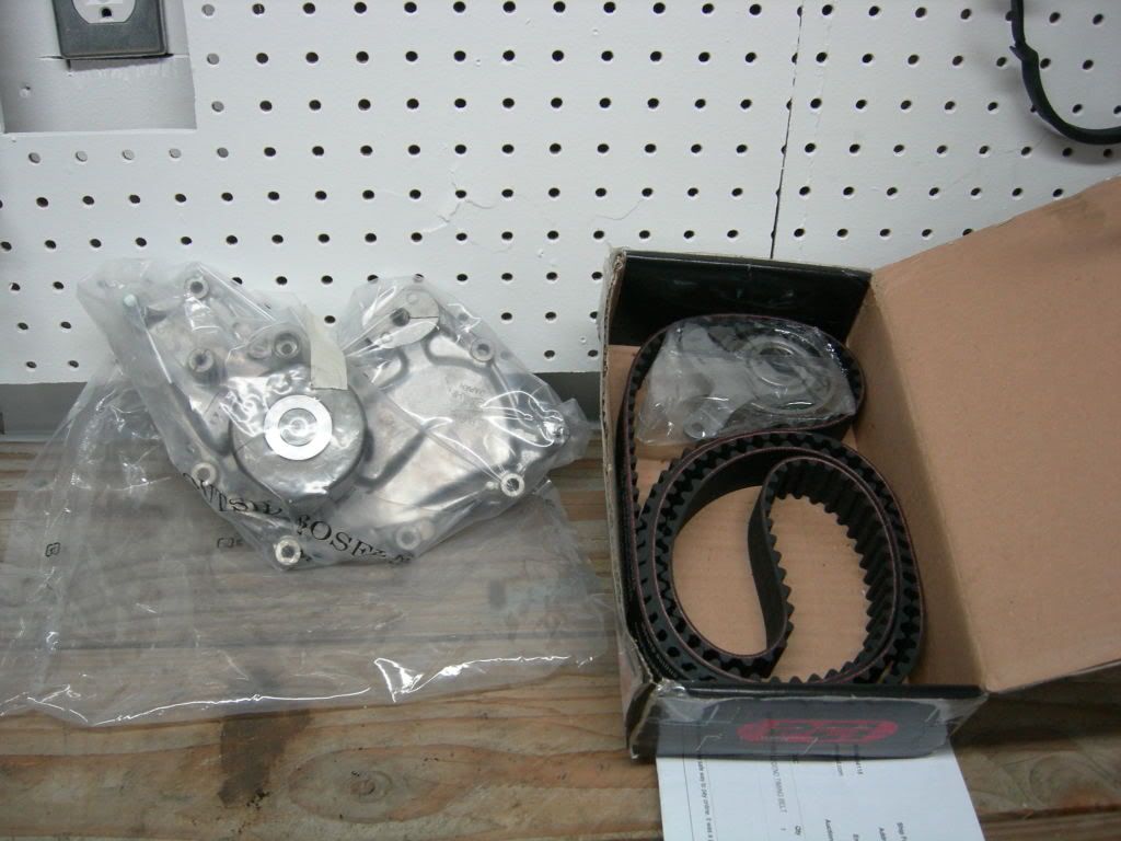

heres whats on the table for her so far
new water pump, timing belt, and tens.

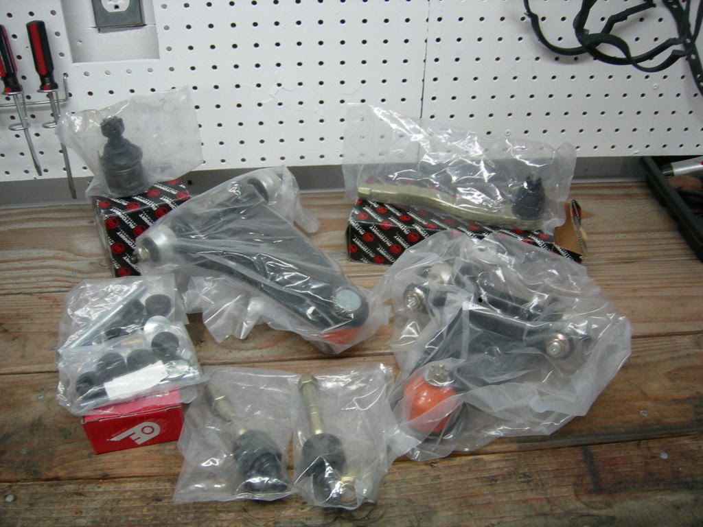

all new suspension parts

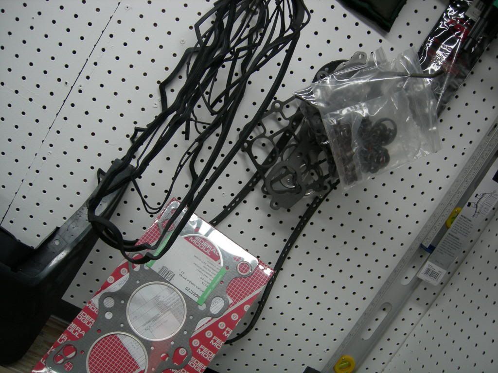

all new gaskets
Photobucket

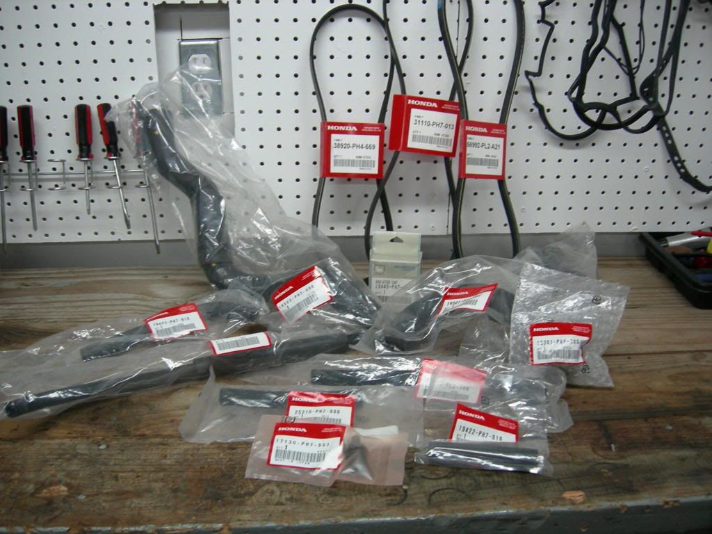

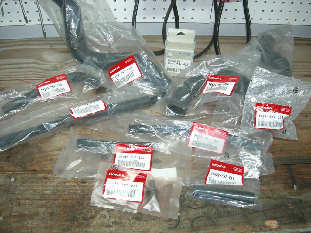

new belts, hoses
Photobucket
these are actually all the radiator and oil cooler hoses. i will now be buying all those other hoses on the manifold.

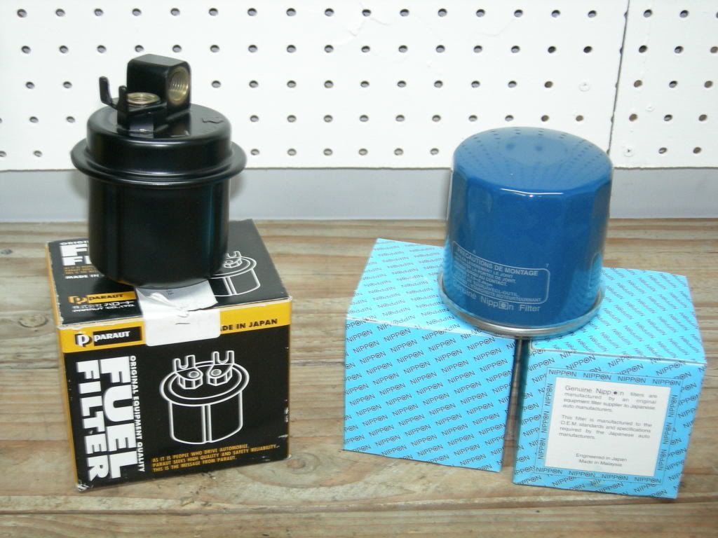

haha first fuel filter and oil filter changes after the rebuild.
Photobucket

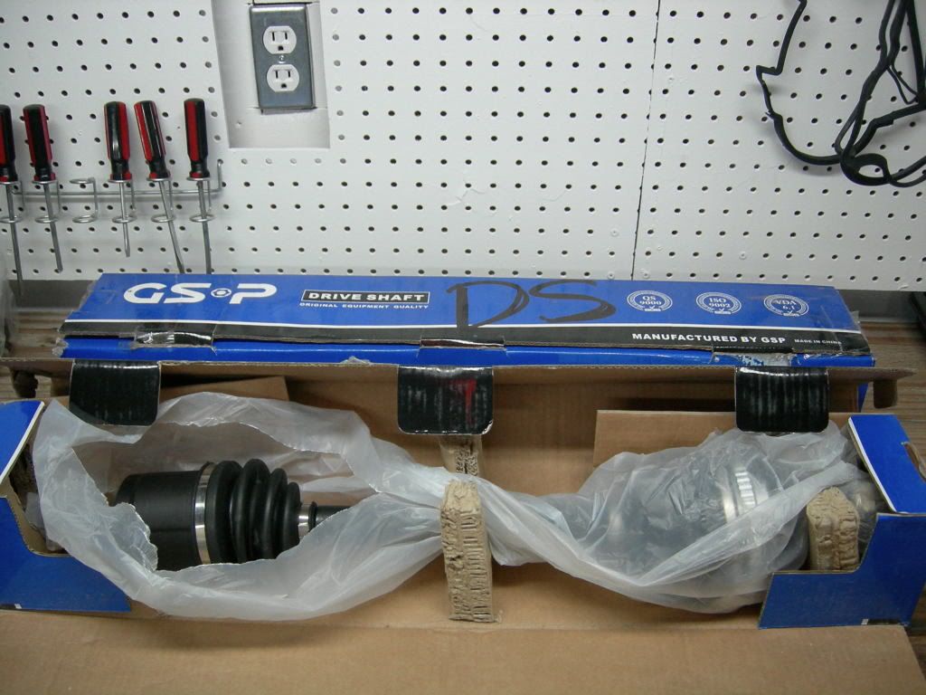

2 new cv shafts
Photobucket

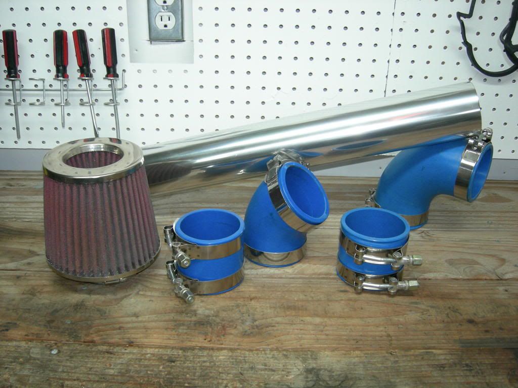

custom intake

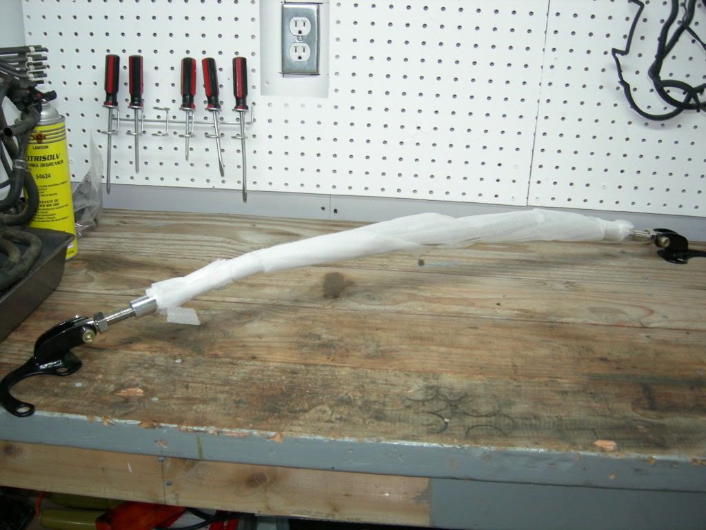

apc strut bar
Photobucket

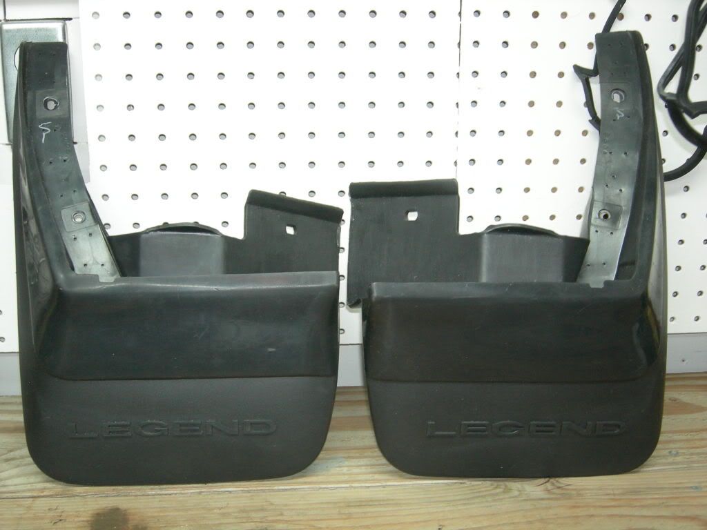

new rear mud flaps

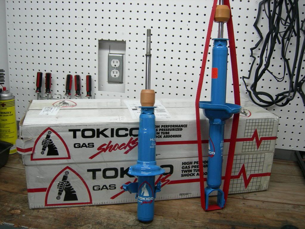

tokico blues
Photobucket

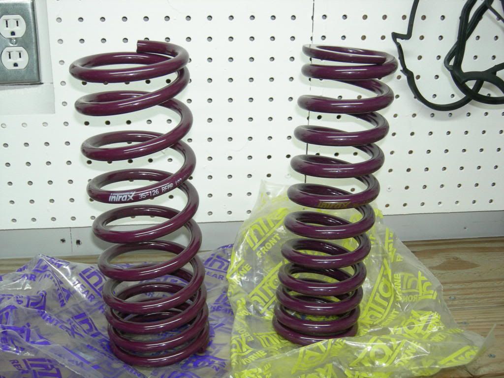

intrax springs
Photobucket

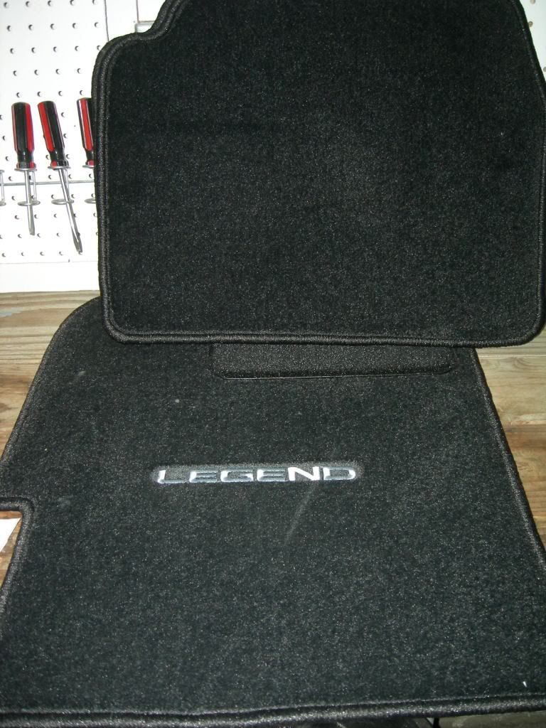

new floor mats
Photobucket

Photobucket
I didn't know they made one for the G1? How much did you get it for and where?
Glad to see your replacing the old stuff on the motor to new stuff :thumbsup:.

thank you. it took me forever to get to this point. that little son of a bitch is a tough engine to remove. so much shit to move or remove. should be much easier going back in though. one thing i forgot to mention is it will be going back in with a 5spd rather than the auto tranny.

its the civic strut bar. i am actually going to take it and try to make some custom mounting brackets to fit around the strut tower better though. i got it off ebay. if i remember right it was like $25/$30 or somewhere around there.
#22 ·
Oh ok, hope it works out. I wish there was one for us G1 :(.
#23 ·
hey i have a general ? about cleaning the internals. is there anything anybody suggests over other cleaners? i'm sure there is stuff u probably don't want to use because of residue. i've been using that citrisolv u can see in some of the pics. as u can guess its a citrus degreaser that leaves little to no residue.
#26 ·
What I normally do is to scrape off most of the dirt/grease mix from the outside with a putty knife or screwdriver. Then I use paint thinner and rags to remove most of the remaining greasy material and finally power wash it. After doing that be sure to dry all the machined surfaces and oil them. The machine shop will soak all the parts in solvent, which should remove varnish. Laquer thinner will also work to remove varnish. Carbon, e.g. on the tops of the pistons, can usually be loosened with engine oil which contains detergents which help to disperse carbon.
These engines hold up quite well at high mileage and you may be able to just do a valve/ring job, have the crankshaft polished, and replace the bearings. Beyond that you may want a rebore and oversize pistons and new exhaust valve guides. Unless you have access to a bore gauge it would be best to have a machine shop check the piston fit.

if it works out and i can come up with good design and template i may be making some for sale. just the brackets though not the bar. time will tell
thank you for the info. i really don't know if i will be going as far as pistons, rings, and bearings. i am going to have the bottom end checked out, but i think i will probably only be doing the top end. if money allows i would like to check into h22 pistons. i don't know much about that though.
