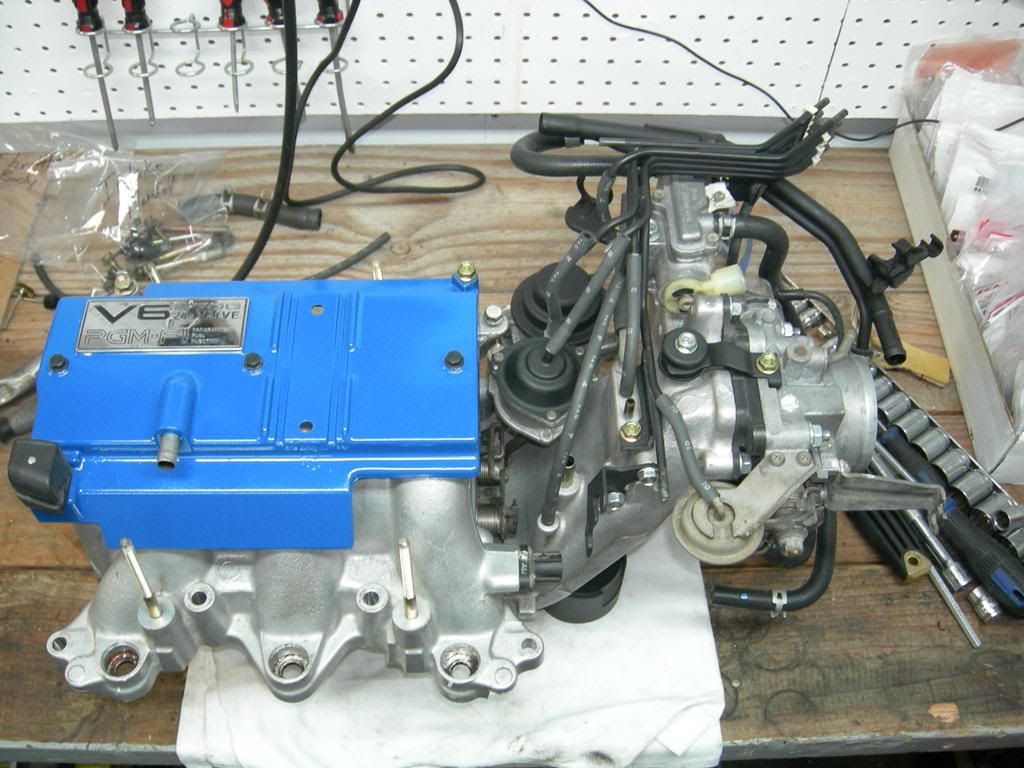

started pulling apart the engine last week for rebuild.
Photobucket

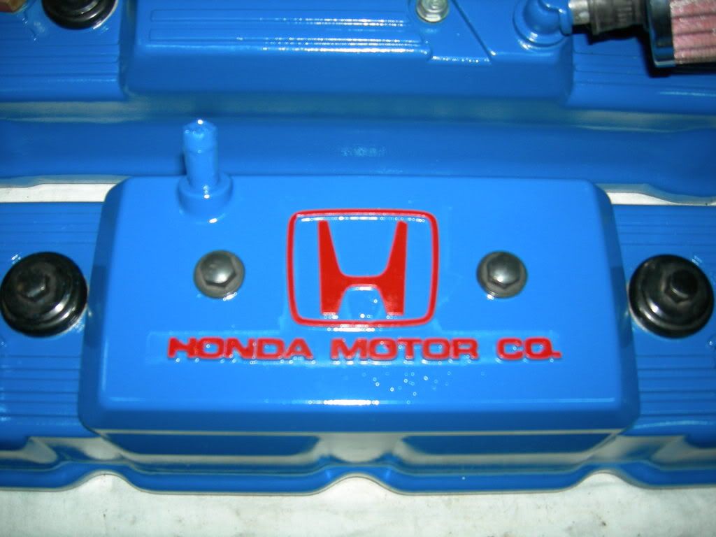

covers prepped for paint
Photobucket
intake manifold removed
Photobucket
Photobucket

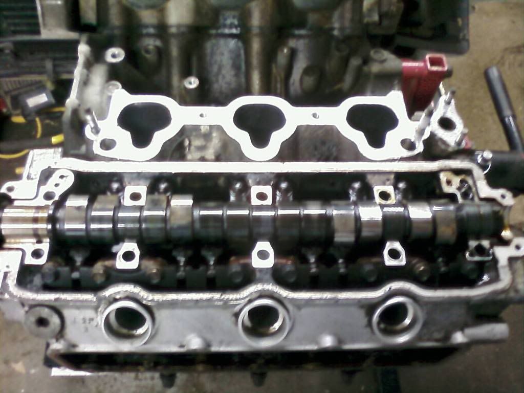

lots of cleaning to do.
Photobucket
Photobucket
and this is what carbon buildup looks like under your valve covers. use seafoam kids!!!!!!
Photobucket

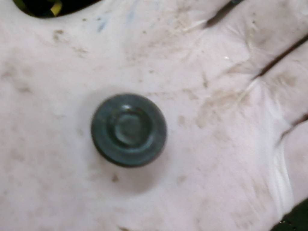

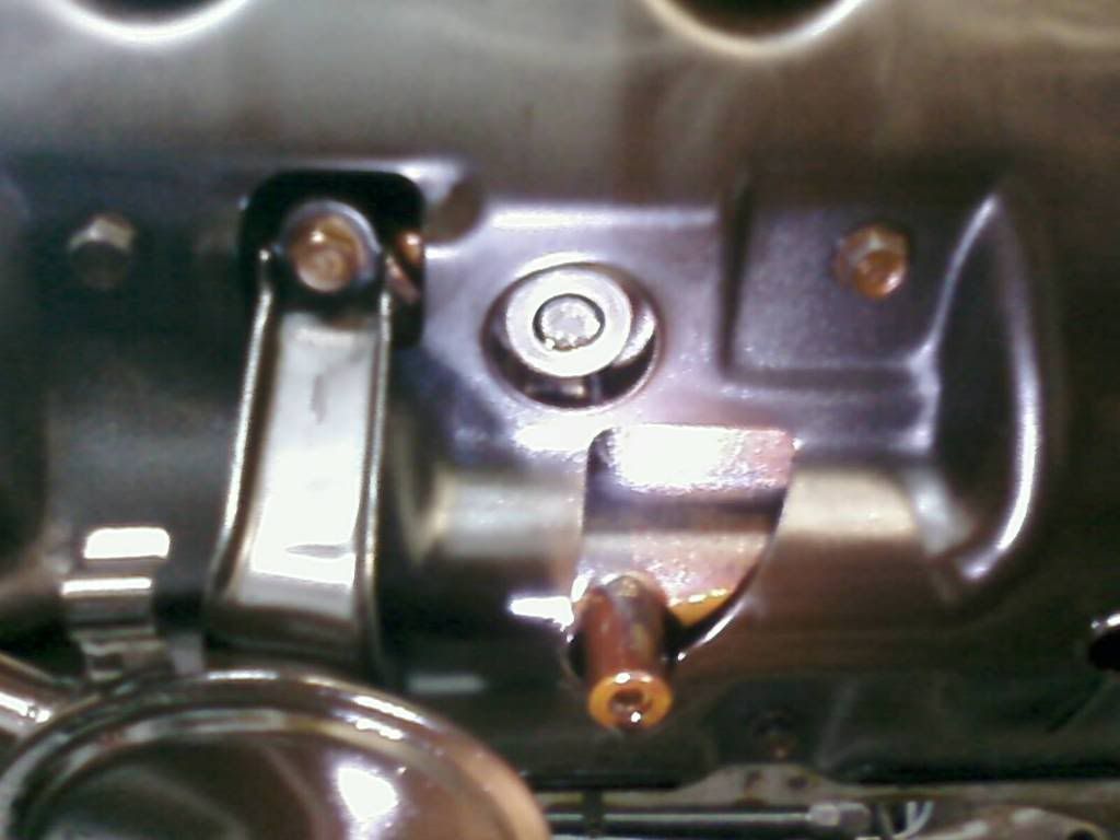

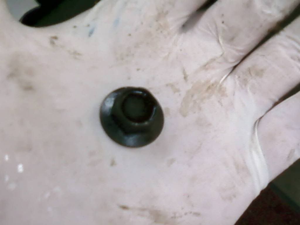

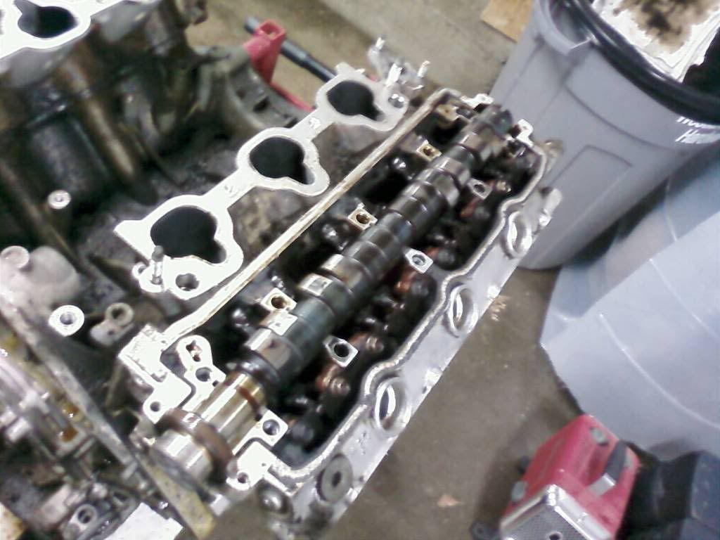

#102 ·
took the rear cylinder head off this weekend. much easier doing the second one :lol:
Photobucket
Photobucket
what i had assumed was one broken bolt on the bearing bridge turned out to be short sighted after removing this
Photobucket
yeah thats right. 3 count em 3 broken bolts
Photobucket
and this one was actually backed out this far. all the bolts came out by hand. no torque on any of them. i was very very worried. and kinda relieved that i stopped driving it when i did.
Photobucket
i just can't figure out how or why.
Photobucket
from everything i can tell though there is no damage to the crank itself. i think i will just have to replace the main bearing on those 2 bridges and i should be fine. what do u guys think?
Photobucket
Photobucket
#103 ·
Everything looks good. I notice the crankshaft journals look fine as well as the one thrust surface that is visible.
The three broken bolts have to be from someone over torqueing them
If you are going to take the crankshaft out you might want to get it cleaned and polished. You may also want to have a machine shop clean up the block and hone the bores.
The heads should at the least have a valve job and new stem seals and check the gasket surface.
#105 ·
yeah i was very surprised to see that visually it all looks good. i was pretty sure i was gonna see some kind of warpage or grroving.
yeah i would say probably over torquing them. the only other thing i could think of is that they snapped when the car was in this front end collsion. i dunno.
yes i do plan on doing all this now. have any idea what kind of price i would be looking at for polishing, balancing the crank, and cleaning the block?

#112 ·
Damn, 3 bolts broken? Fuck man, glad you opened up the bottom. How much would it cost to polish the balancer anyways?
#113 ·
Likely costs are:
polish crankshaft journals $75
clean block $100
hone bores $50
valve job $100 per head
I'm more concerned about the apparent crankshaft damage, though it's a bit
hard to know from the pictures, but the crankshaft counterweights should be the same color as the rest of the crankshaft, i.e they shouldn't look like machined surfaces.
My concern is that there is a severe thrust problem, which usually arises from a warped block. If that's really the case it would be better to start with another core. The way to test for it is to remove the piston and rod assemblies and reinstall the main bearing caps, then pry the crankshaft front to back and measure the movement with a dial indicator. Check the specification, but a typical value is 0.005-0.010".
#114 ·
stephen said:
I'm noticing some of the crank counterweights are very shiny on the sides like they have been rubbing against the main bearing caps and saddles. Have you checked the crankshaft end play? It may be way out of spec.
i think u r seeing this shinyness from the flash of the camera.
they r the same color as the rest of the crank. burnt oil brown
#117 ·
stephen said:
I'm referring to this picture.
pics033.jpg picture by bobbo78 - Photobucket
It looks like the thrust washers are worn down to where the counter weight is hitting.
ya know i can't really tell from the picture either. i will have to take a closer look when i get home tonight. maybe try to take a better picture too
#118 ·
well after closer review i see where u r talking about. and yes there is some wear. once i get the piston out i will check the movement of the crank. also i was only going to change the main bearings wear the bolts were broken. is this ok or should i replace all of the main bearings at the same time?
#121 ·
You might as well replace all the main bearings, since they come as a set.
I just used standard bearings and didn't bother with selective fit bearings.
To get the crankshaft end play right you will need to replace the thrust washers. You can rotate them out by pushing down on one side with the main cap off. If with new thrust washers in there the crankshaft end play is correct you should be OK, but you should get the thrust surface on the crankshaft at least polished. If the end play is too large even with new thrust washers the may have to weld up the thrust surfaces. It would also be a good idea to have the main bearing saddle and cap alignment checked and possibly have it align honed.

#124 ·
stephen said:
From the pictures I can see that the crankshaft has been pushed forward while running. This is probably from a bad torque convertor. I think you said you were going to install a new transmission (manual).
yes i am putting a 5spd in it. the auto will not be going back in.
