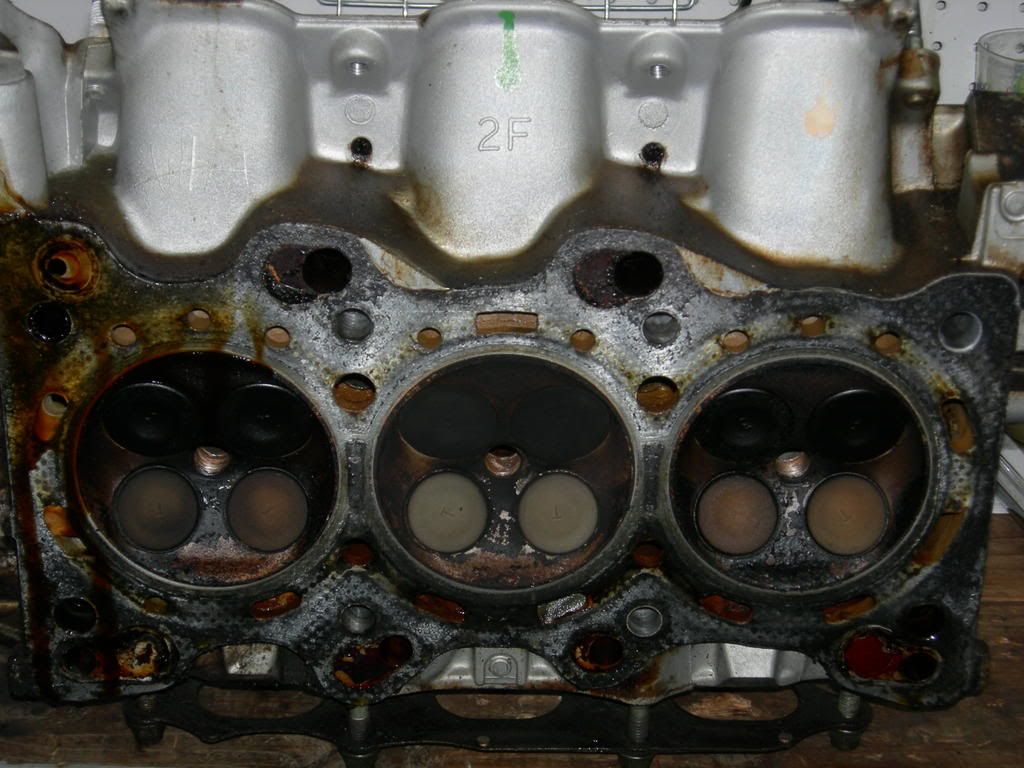

Discussion starter · #90 ·

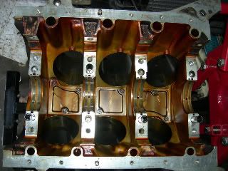

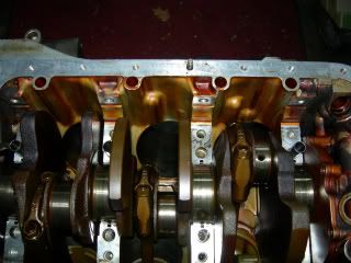

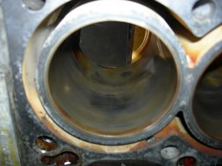

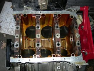

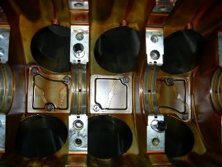

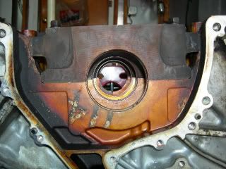

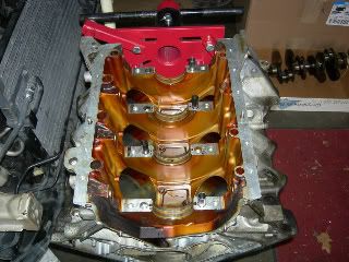

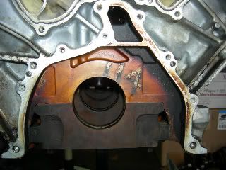

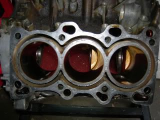

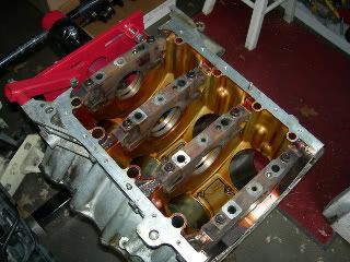

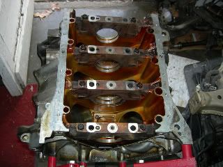

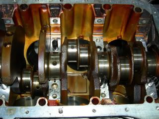

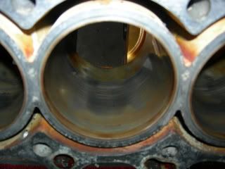

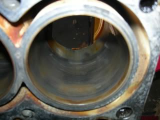

so i got my head off.............
Photobucket
lots of carbon buildup
Photobucket
Photobucket
Photobucket
Photobucket
i got gravel in my engine :lol: can u see it?
Photobucket
It all looks pretty good. There is rust in the water jacket and it looks like the head gasket may have been seeping some from the looks of the rust stains on it. However, the gasket surfaces look good and the cylinder walls look good.

What is that just carbon? have you used sea foam in your engine?
Looks like you have good progress only for that broken bolt...
keep us posted you doing great... I have a complete 2.7 if you need parts, I won't advice for a used bolt to replace the broken one but if you want I will let you have it for free...
Damn, that's a messy piston lol. I'm a bit surprised to see rust on the sleeves. What are you gonna use to clean the pistons?
There was a neglected cooling system and it distributed rust around.
The carbon on the top of the pistons can be loosened by letting engine oil soak
into it. I would recommend new rings, because the rings are likely gummed up or full of carbon.
The broken bolt on the nearing bridge was likely due to a casting defect. It will be no problem to remove it after the bearing bridge is out. It is actually in one of the main caps.
