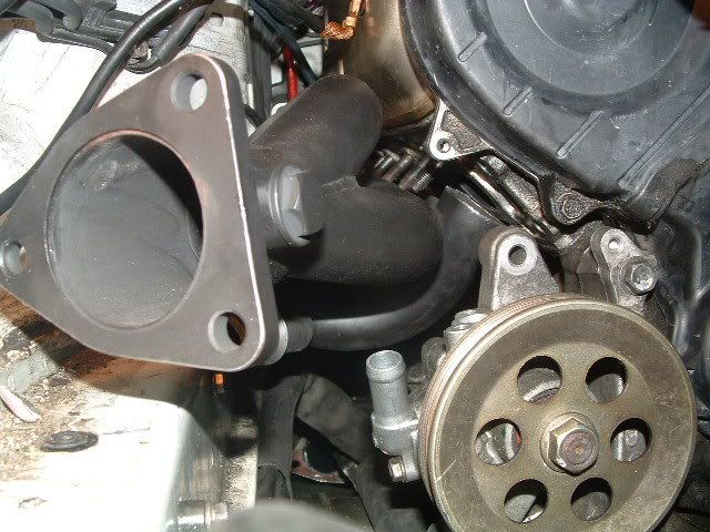

First I apologize for the serious teaser and putting up pics of a project without results and dyno's because there are none. And who knows how long it could be before I go any further it could be a year or more! I just love hearing the ideas suggestions, feedback and knowlege you all have to offer. Isn't that a bulk of what we are here for? :) Well as many of you know I am currently underway with the Supercharger setup. It has been a very slow process but is still underway and the manifold for it is now being welded from what I understand.
I could not get over how much I loved Hotlava's tt setup and it overcame me. So I figured at some point in the future I also wanted to do a tt setup and began slowly buying the additional pieces it would take to do so (being that many are the same, such as injectors, fuel pump monitoring gauges and what not). Then last week my car decide to get some garage time (it broke down later found to be a broken axle, Ebay? I think it was tsk tsk). But none the less it was a perfect excuse to play while she was down so I started to look at how I would eventually want my tt to be setup. What better way than to play. It helps kill concepts that look good in your head given the (not so) workable space; a few of my ideas have since died. But long story short this is where I am at so far. Now that my wife knows that it is just a broken axle I only have shipping time to continue playing before having to put her back together again.

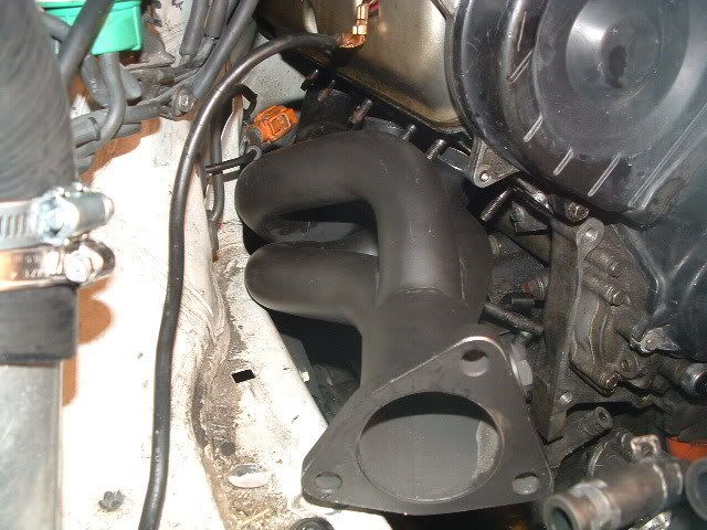

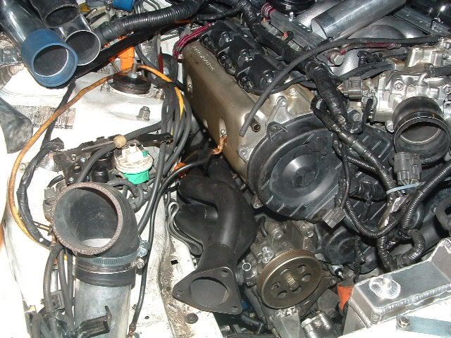

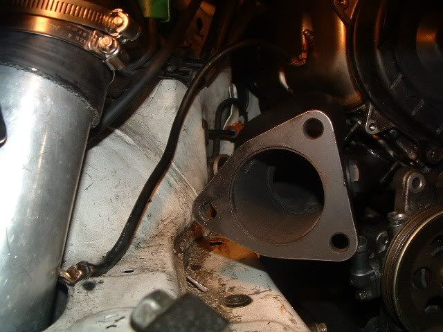

Ok the book is done here's the pics. (excuse the mess my garage is at war)
also please forgive the ugly "stand in" mesh and terrible paint, looks will come last. I don't want to tear it up after doing body work and paint.

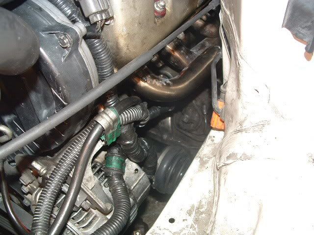

This one concerns me, there is not much rook and there is a damn brake fluid line that may need to be relocated. wires and hoses I don't mind moving brake, AC, and power steering lines I am not so happy/experinced with.
Hopefully at some point I will be done destroying my car and be able to build it up like the one in my head lol.

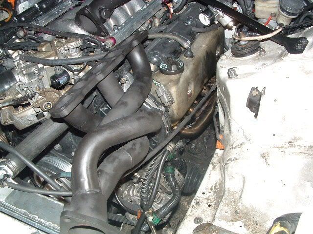

Well here are a few more pics to show symetry and size before the go back to be welded up. It is coming along well, Thank you Vic!
collectors should be here any day (hopefuly the water temp gauge will be too)
#403 ·
Ohh those headers look mean!!
#404 ·
Thank you, hopefully the work will pay off.

im impressed telion, its coming together very nicely, how are you going to route the exhaust after its fed to the turbos?
#415 ·
I apologize for not coming back to this Forevrea, first I wanna say thank you for the compliment it means a lot. As for the exhaust route the current plan is to run a y off each turbo closer to the passengerside of the engine and between the radiator and the engine behind the front part of the suspension rack (this is from memory sorry), then axleback style over the axles and then straight back. I will see if I can find a pic.

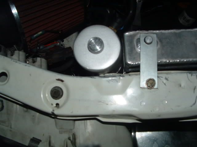

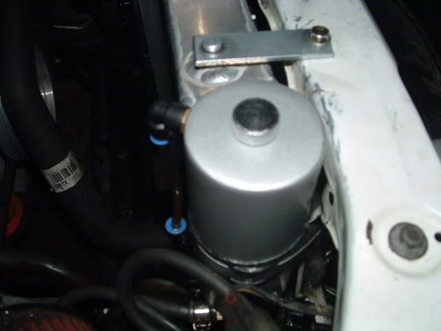

Black reservoir with a yellow lid where our fuse box is: is that his coolant reservoir?
It strikes me as a bad idea to put such a large heat source as a turbo right next to the line carrying that little bit of extra coolant into the radiator when the thermostat opens. Won't you be making the cooling system work just that much harder?
I suppose it's an inevitability really: turbos are going to bring heat into the system one way or another right? Hopefully the Legend's design is up to the task.
[Note: I'm guessing here... it's just what first occurred to me when I was watching that video and I'm curious if it's of concern in your design Telion]
#423 ·
Well a few things if you are referring to the side coming from the turbo going into the TB than nope not doing that but it looks cool and I don't think it would impact the cooling ability of the cooling system ( which I also aided with an upgraded all aluminum C&R racing radiator with a SPAL high speed fan). Also though it looks cool, wonder what type of intercooler(s) he is using. and I would not merge at the TB like he did. Ok just re-read the email and see the overflow reservoir and I don't see that as an issue I would probably shield it from the headers, but as long as it doesn't melt it should be fine. mine is actually located in the front driverside wheel well.

Hmm possibly a benefit to having a coupe (and a 91' bumper)? Yeah I agree though with the spoiler lip or atleast the area behind it. I do have the Sarona front bumper but I am shying further and further away from putting it on this car. I will try to get a pic up of how I mounted the reservoir though it may need to be re-fabbed out of aluminum depending on the heat.
#426 · (Edited)
Ok, I mentioned that I would put up a pic of the location of the reservoir so here it is with a few other semi related pics.
