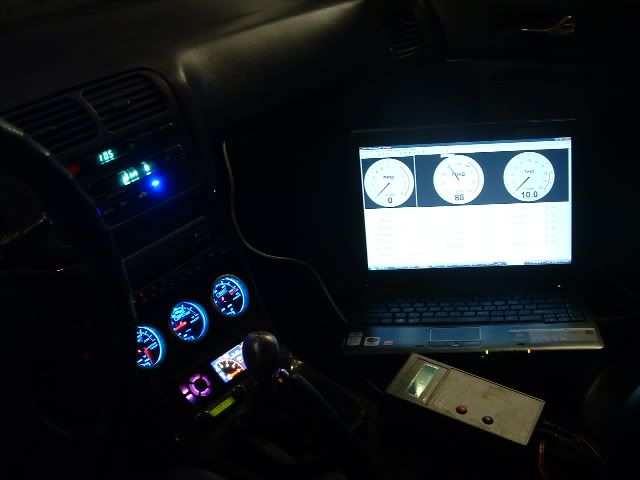

The next step will be working out the kinks, getting everything to function properly, getting the gauges all hooked up so I can read realtime what she is doing (mostly done) and then tuning from there. That's the agenda anyway. Right now I just wanna get it where I can safely rev through the powerband and feel good about her idling for a few moments. The throttle problem is on prev. page. Almost forgot I am working through this in stages so the Walbro is not hooked up yet that will likely be next, and I gotta get the 450cc injectors ultrasonic cleaned and tested so they are not in and I will install the Phantom grip in the next engine pull. But I am very far from being done. This was just a step to keep me motivated, and be able to pull it in and out of the garage to shift cars around so I can get a few things fixed on the daily drivers.
