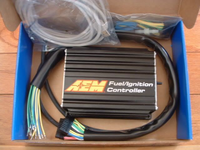

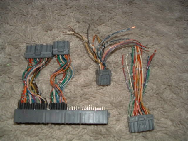

Ok you guys know me and my inability to withhold any information regarding this build so here is the direction I decided to go. I didn't want to take any uncalculated risks regarding engine management. I just have too much money (to me) into it to have it go into a closed loop AFR of 14.7 and cause a serious problem or damage. Though I do think that potentiometers would be effective I decided to address a couple other things at the same time. This solution addresses the map sensor, single cell map tuning ability, and having an item with an on-board interface and real-time tuning for my Car PC and/laptop. So at that point I knew what the clear winner was. Then I was able to find it at a smokin price of 318.00 shipped brand new after a discount coupon I had been sitting on.
This is the pic of the conversion wiring harness that I am working on so that it is easier to transfer from car to car with the addition of a line to the manifold vac port.

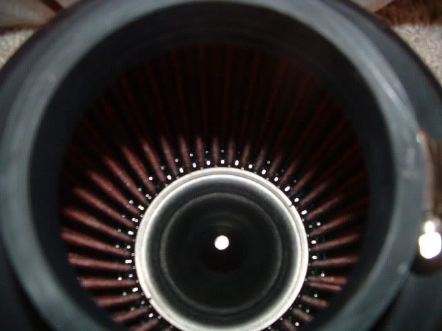

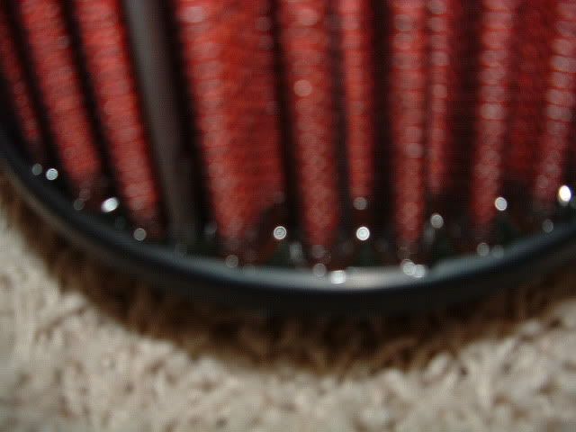

I also don't think that I mentioned in this thread that I did decide to go with Fujita on the intake filters.
I am pleased with the amount of glue they used to seal these this often is an issue with cheap filters.
Though it would be nice this doesn't come with the unit I found it on there forum.
